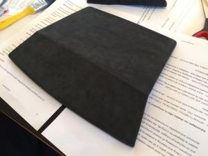

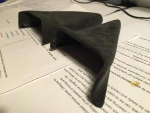

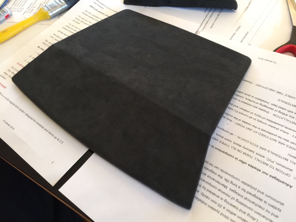

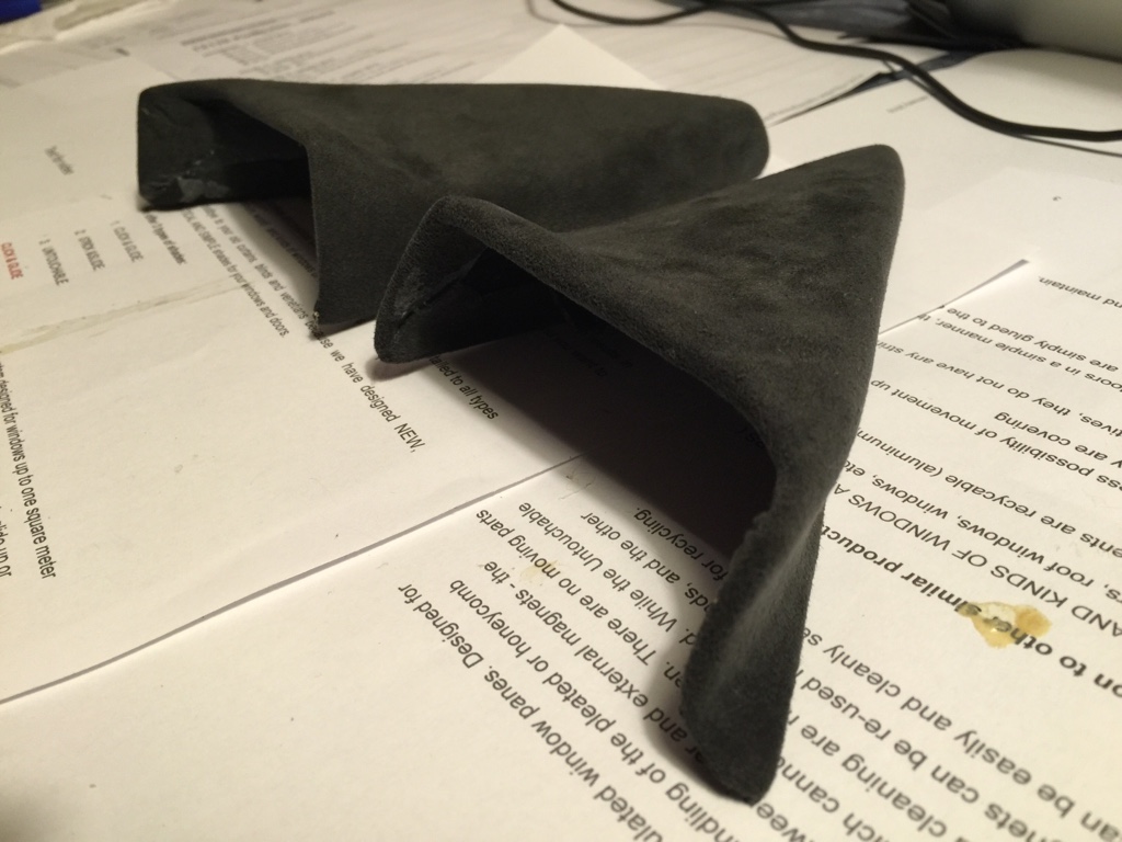

Some alcantara stuff I got. Have the intruments cover and airbag covered too, but no photos yet. Door cards, and seat center parts will be covered in anthracite alcantara.
Love your P2 conversion. Still one of my dirtiest wishes :P But I probably need a complete P2 car start my project. So that will be for the long term sort of say.
Also the alcantara is very nice, I really like this. Alper Musa did a hel of a job with alcantara :)

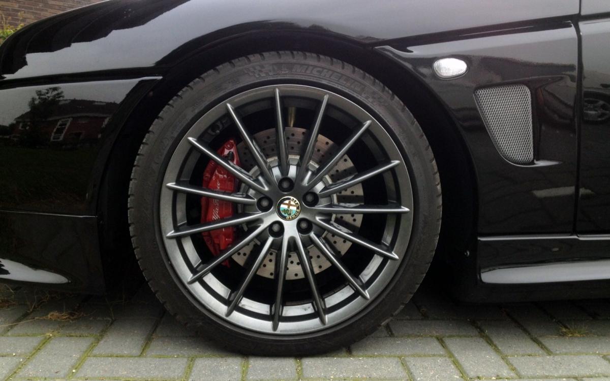

For the GT Toora wheels I coated them in dark metal with a high gloss finish. I didn't like the gun metal gray that much. they use it allot on the subaru rims. This was more my thing.
Adaptors for larger rear discs are in the works. Fiat Ulysse discs will be used (295x10) with the original calipers (Thanks to Fabian and Thanos).

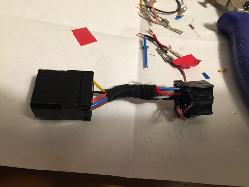

Here is pic of an adaptor I have made to use P2 center clocks. P1 connector is on the left.
Two wires are missing on the pic that go to another connector for the fuel level sender in the tank. P2 cars have the sender intergrated in the pump and P1 has a seperate unit.
