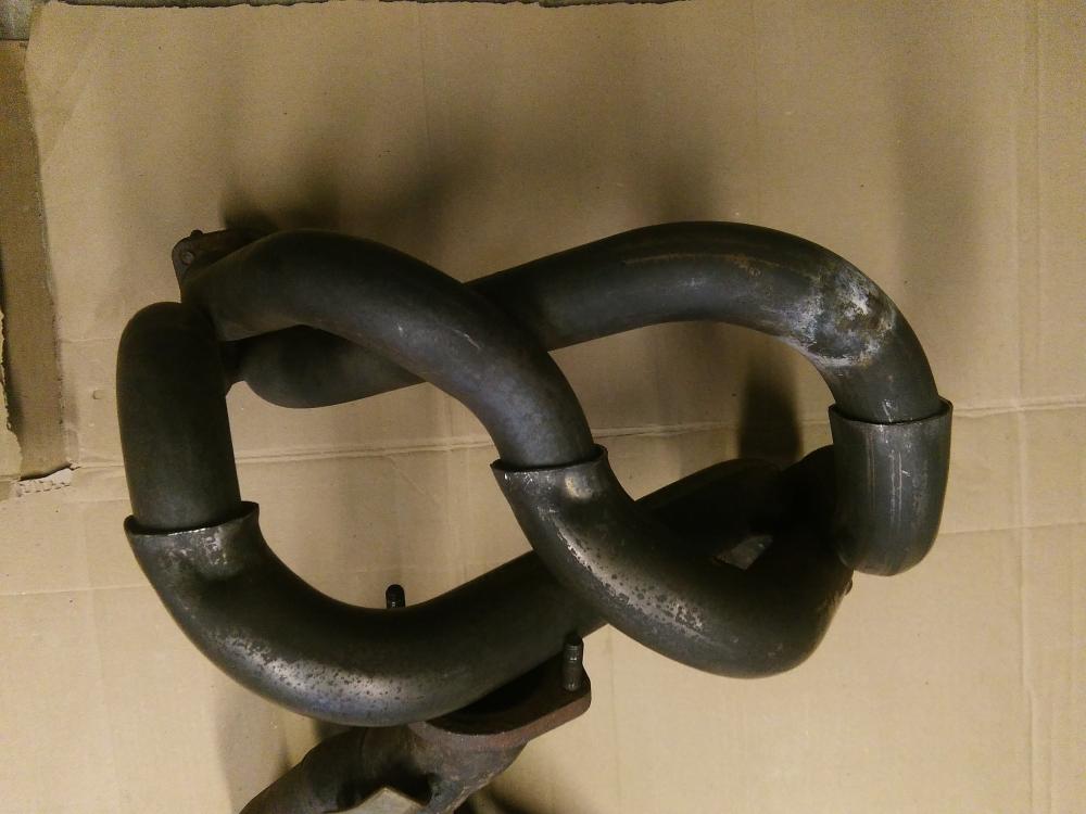

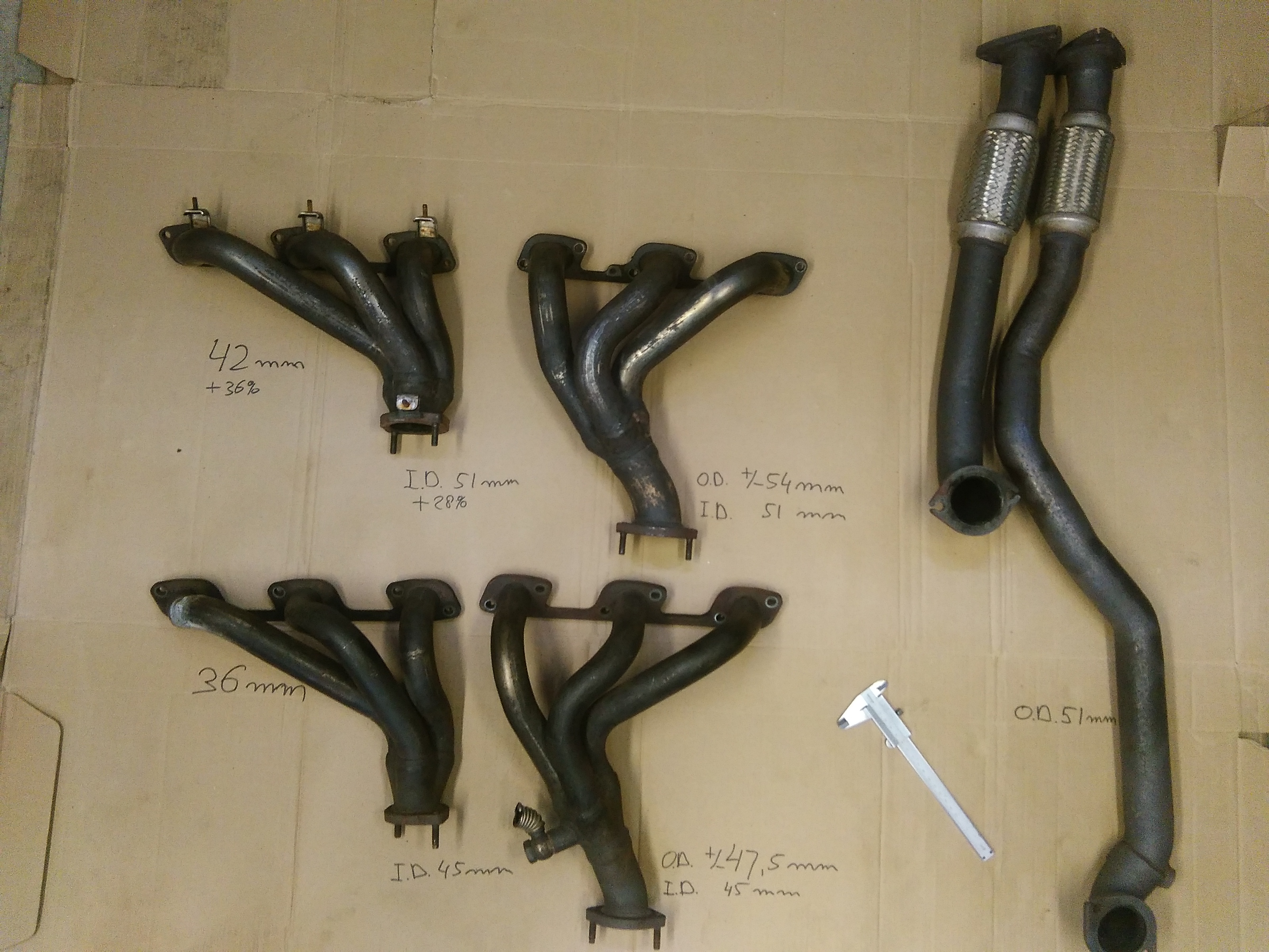

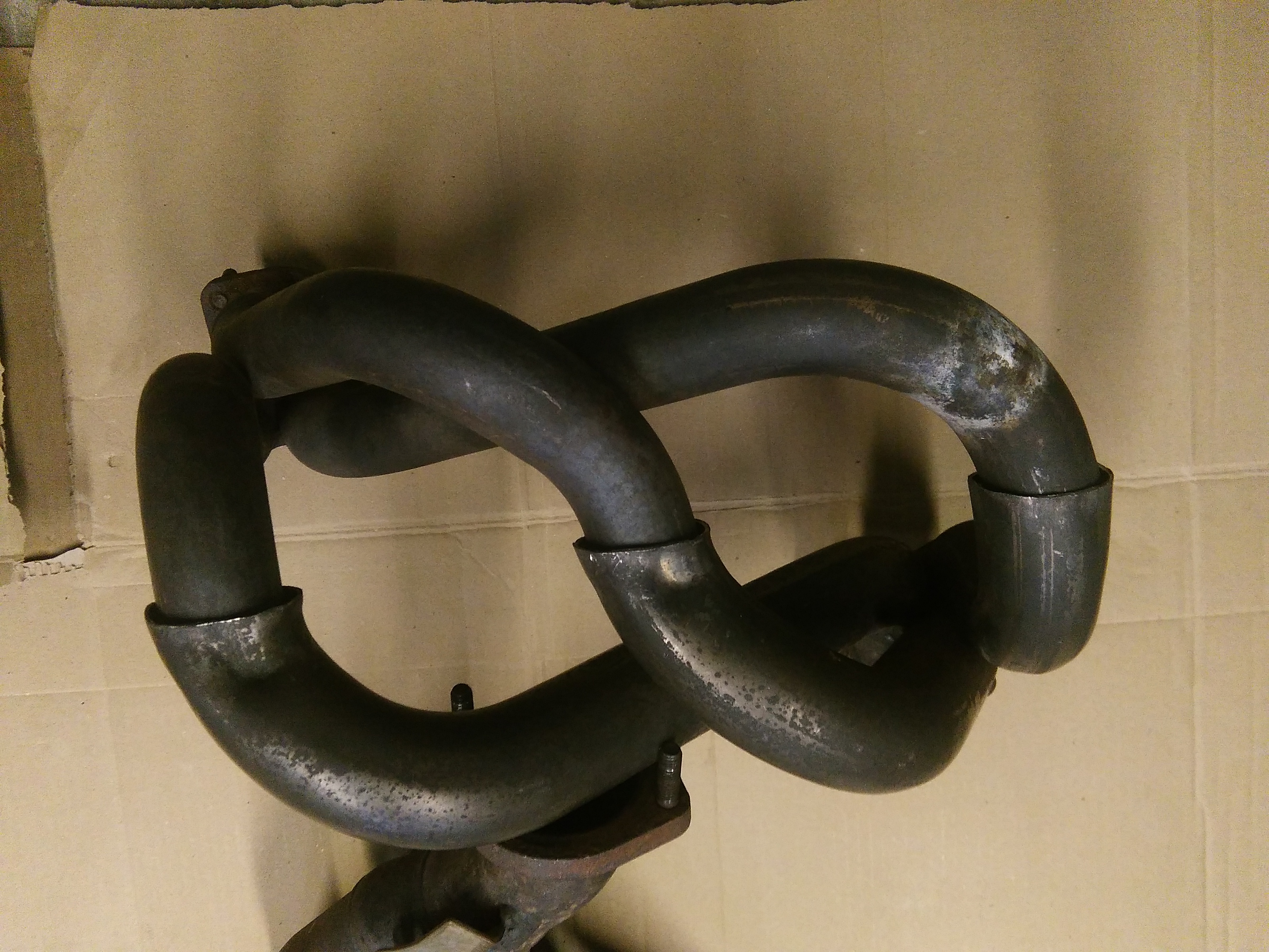

Here some pictures to compare:
1st pic: Some comparing measurements. Primairies are 40% bigger considering the inner diameter ID (not 36% as stated on the cardboard, which is is the difference in area of the OD).
2nd pic: 12V headers fit easily inside 24V headers. :D
Edited by Carlo
