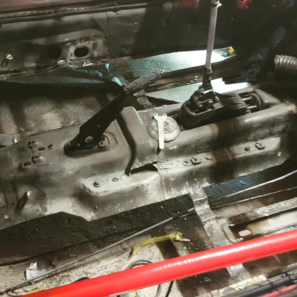

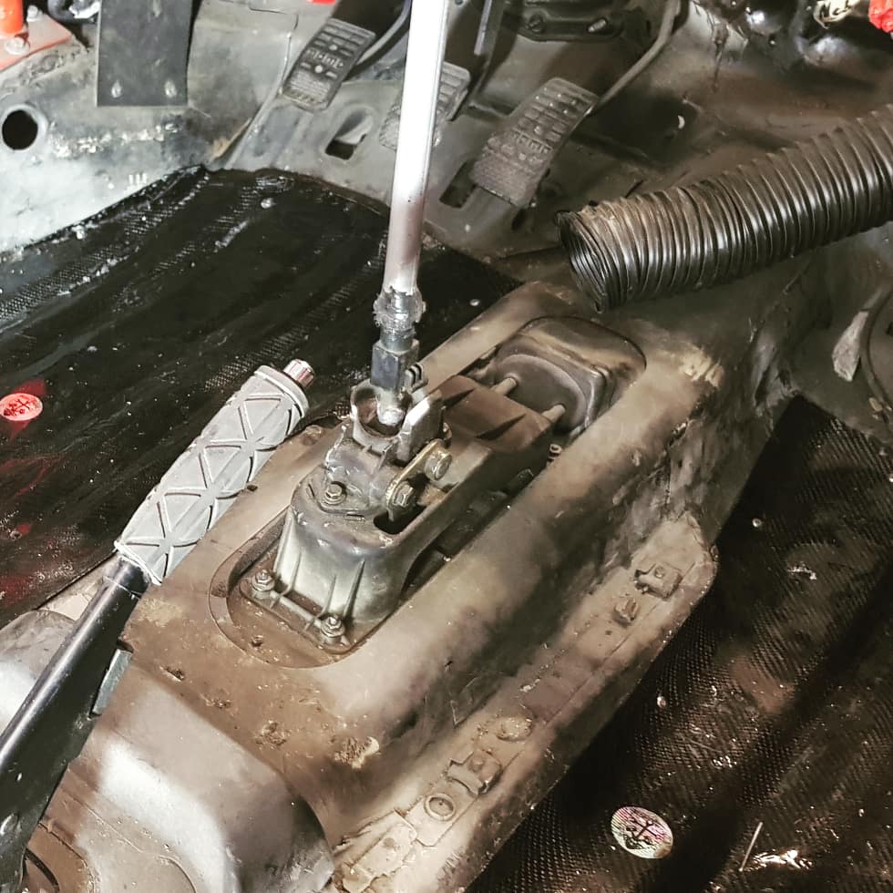

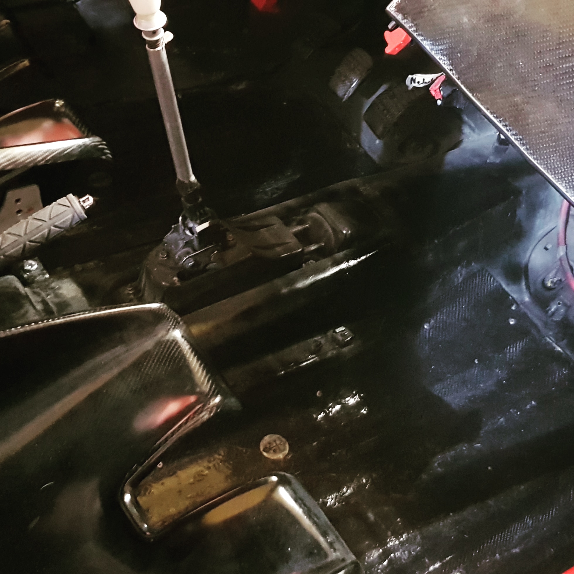

Here some news. the CF floor is now finished. :)  even when the ultra glue of death was wet it was possible to fully stand on the floor. it actually moved less than the steel one.
Now its fully cured.  I didn't think that the original floor would be just 1.5-2mm. I could have made the cf one slightly thinner. But anyway its not just weightreduction its also a gain of stiffnes :)
The actual numbers are
6.5kg stock floor
4.6kg cf floor ( I thought it should be just 1.3kg each, but it seams I made more layers in the 45° angle than I planned to do.
0.3kg Super duper Epoxy glue
1.5kg saved ^^' but here we need to add also the seat mountings, wich will go CF of course. this save additional 1kg I think.
Ready for the next weight reduction mod :)
( on some blueprints I saw there is a thick metal under the shifter. This has also found its way to my list :) also the steel handbrake :) )

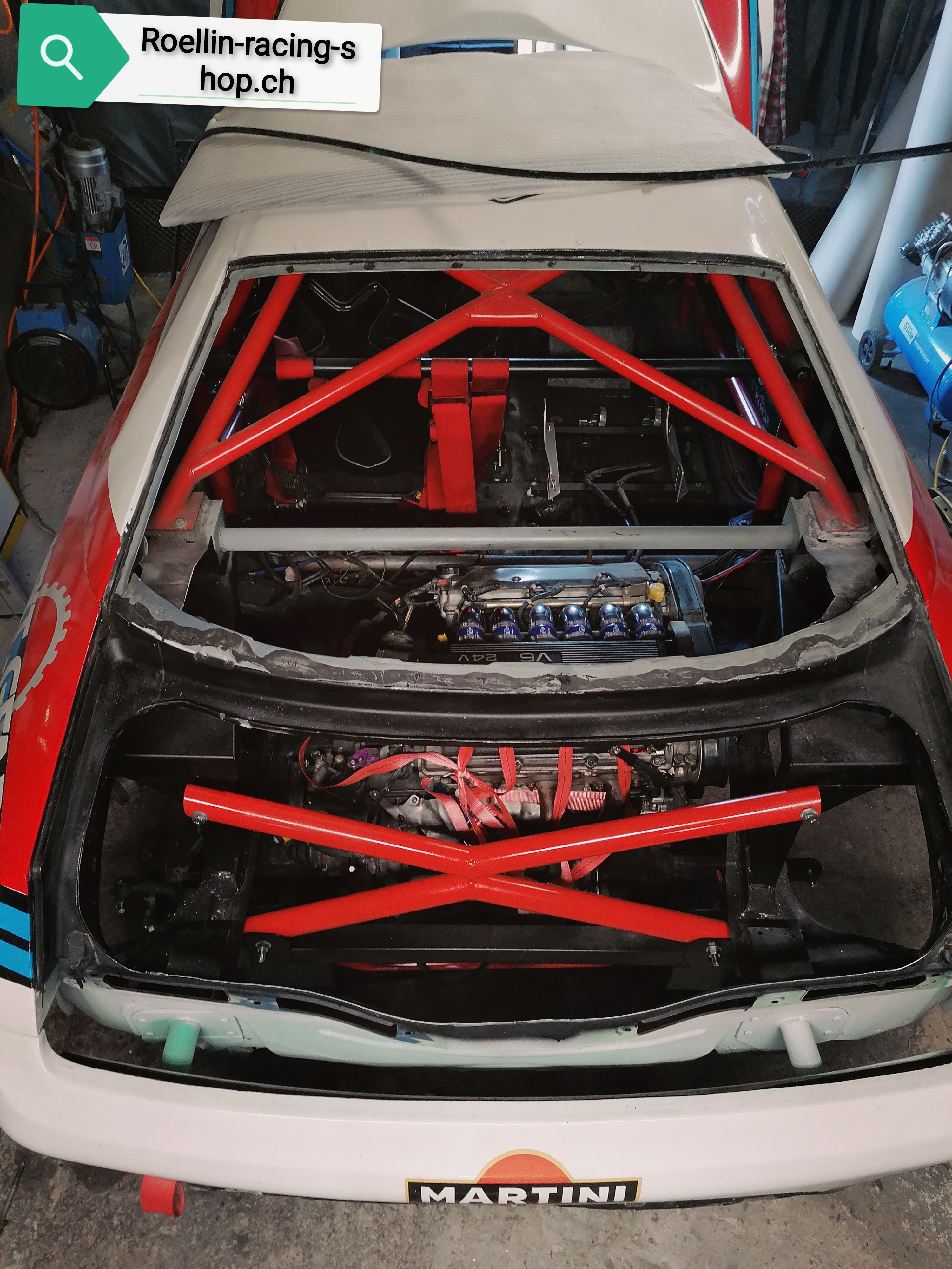

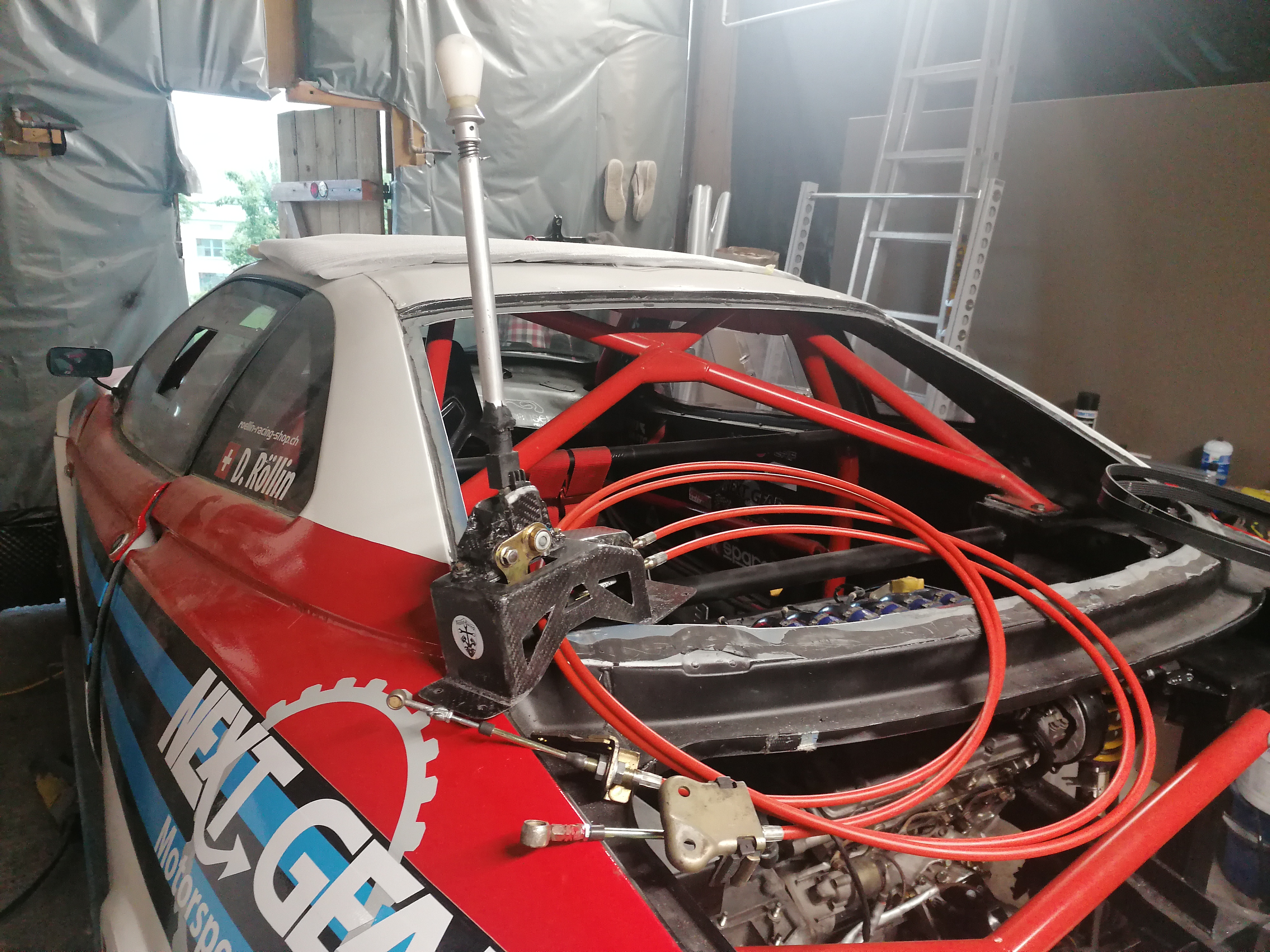

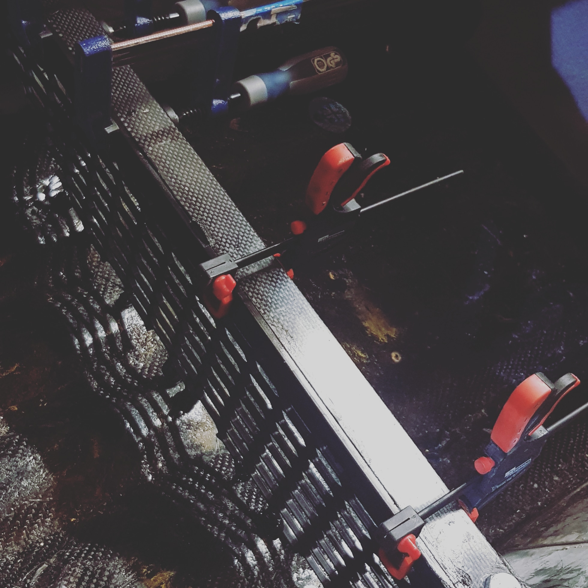

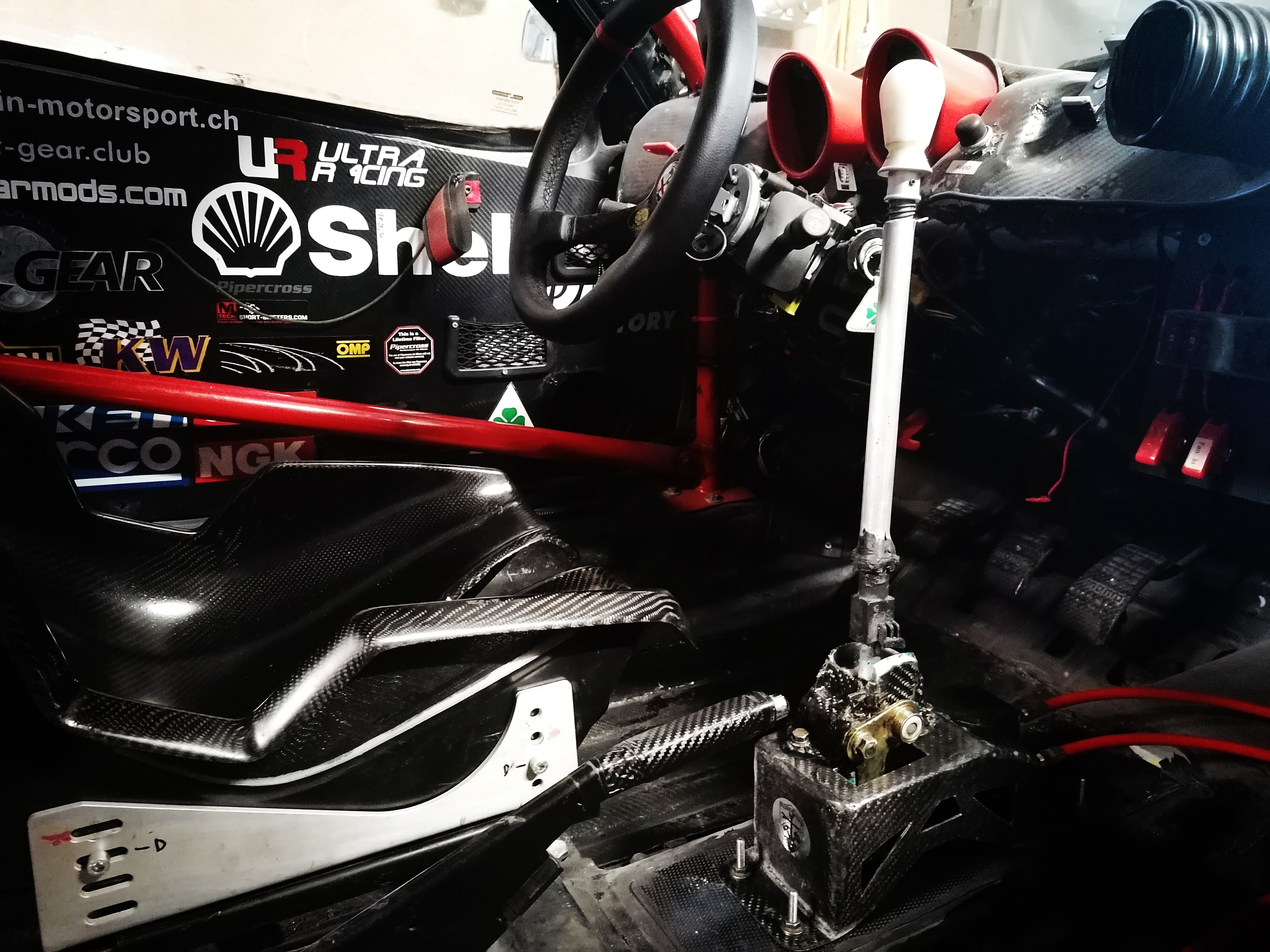

The beast runs and drives :) all is comming together
Carbon dash, carbon seat struts :D
I soldered the gas pedal connector for more stability
At the moment I am building a diffusor.
The Quaife Diff arrived, this will be mounted with a solid flywheel and a upgrade clutch.
Just a few small things and its ready to hit the road

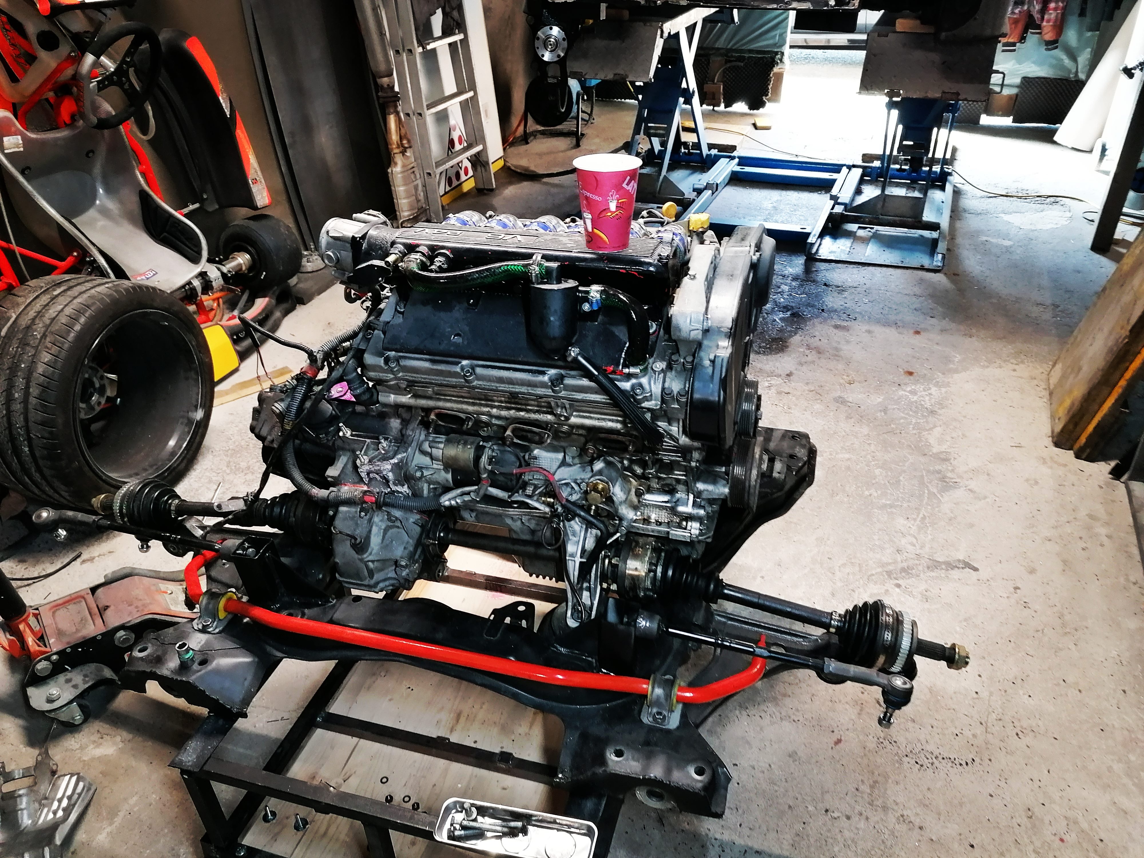

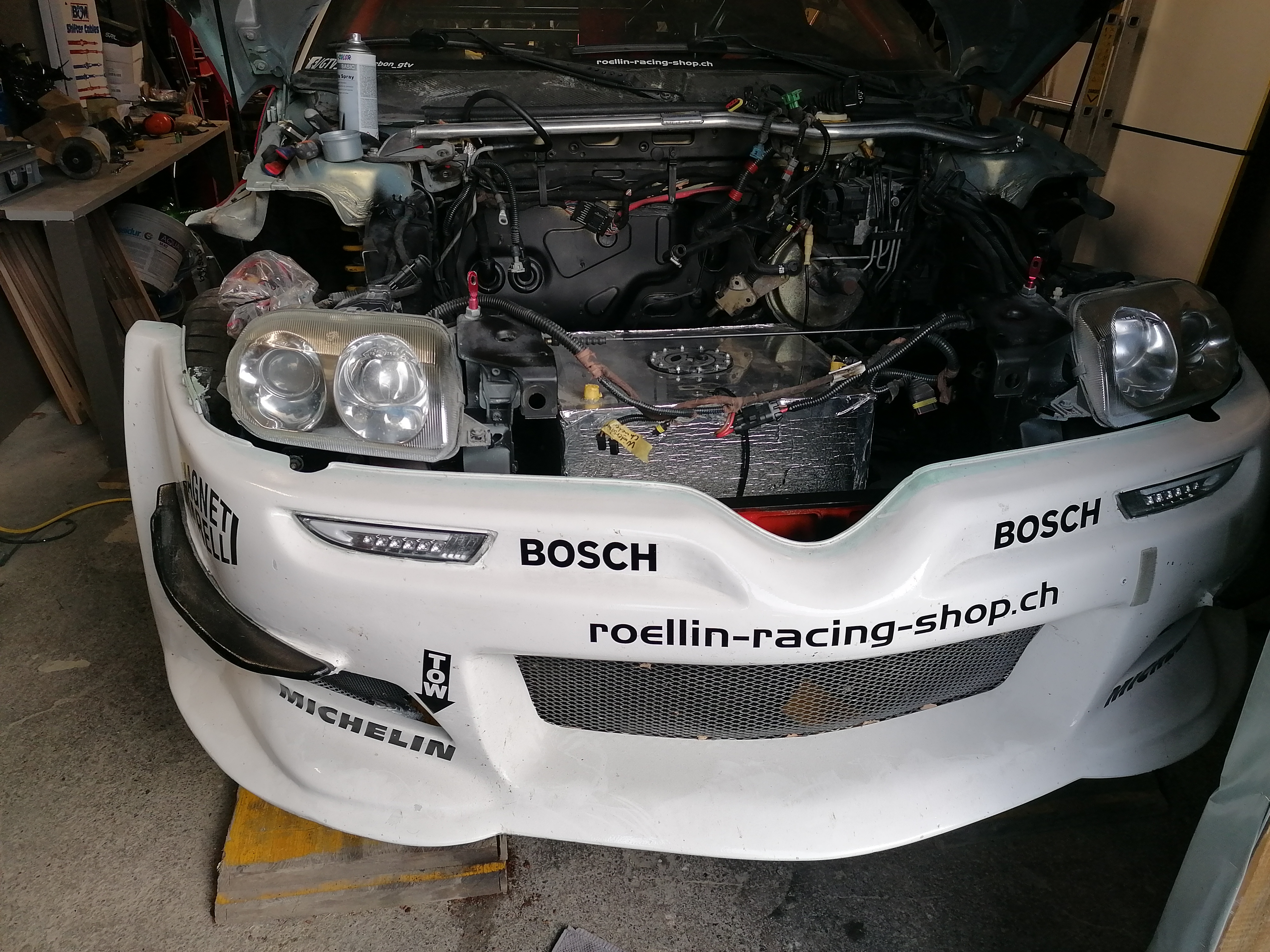

the package ist finished and ready to go finally in. will be a lot fun reconnecting all pipes hoses and wires ^^'
also incredible much work :S but it will be the ultimate GTV. I even mounted the alternator in front of the engine to get best weight distribution :)
