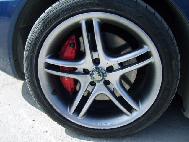

I also didn't have to grind off anything from my caliper when I installed mine. Check my picture below from the set I have installed.
@GBINSB
Where do you bought the mounting brackets?
Edited by finstyle
305x28 GTV/GTA discs?
You don't have to grind the caliper because of the bracket, but because of the hub 'ears'. The caliper is too close to the hub.
