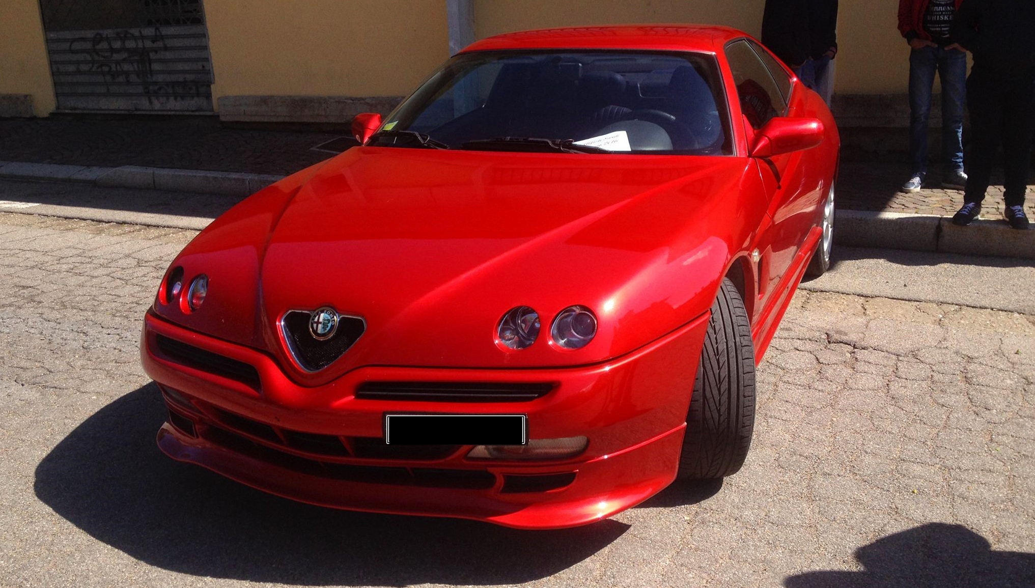

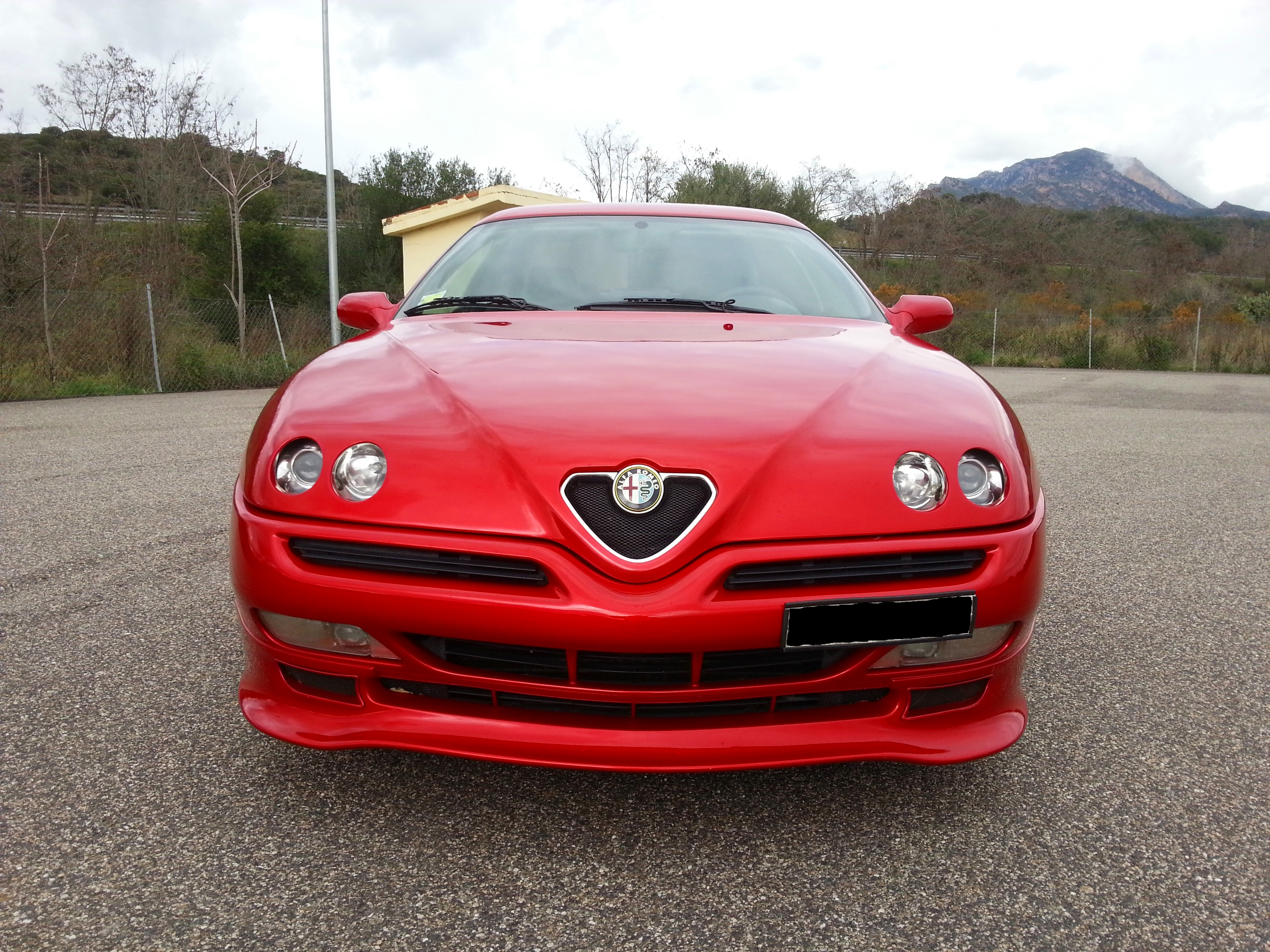

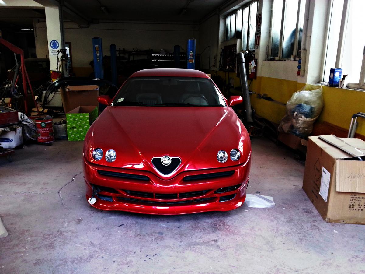

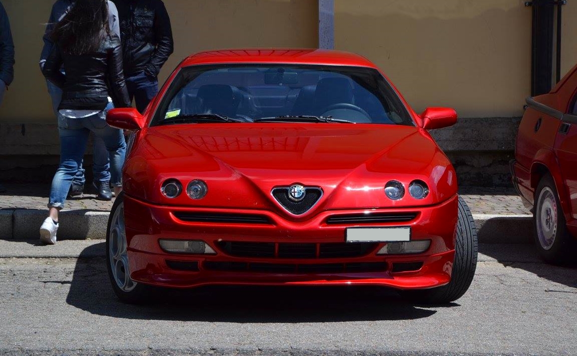

Hard to say under artificial light but colour looks not as dark as alfa rosso 130. I am curious how that will look in daylight as I am also going to respray my GTV in a brighter red than orginal (130). Any pics outside?
At the moment no pics outiside :)
I'm curious too, I am waiting is finished.

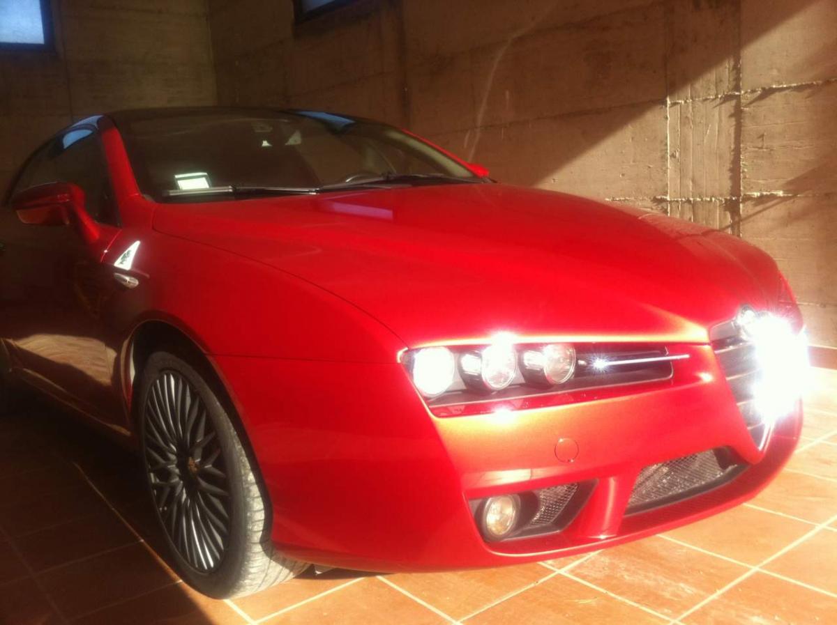

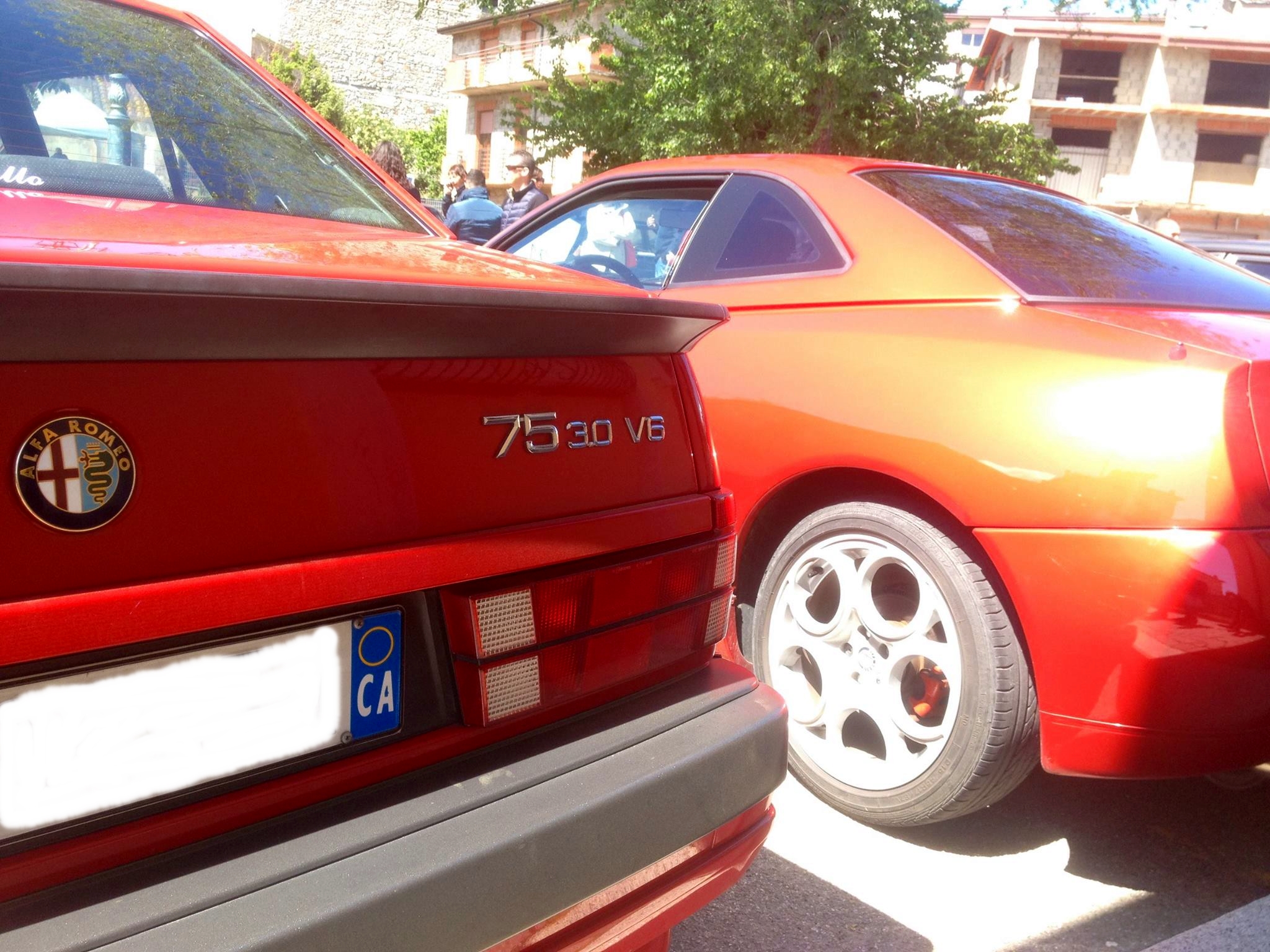

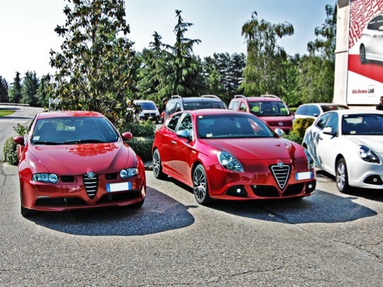

Here you can see the color difference on a Giulietta.
post-834-0-58027500-1427016396_thumb.jpg  rosso alfa
post-834-0-06187900-1427016450_thumb.jpg  rosso competizione
post-834-0-05665500-1427016745_thumb.jpg  147 rosso alfa 130, giulietta rosso comp.

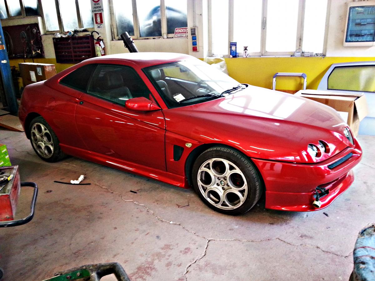

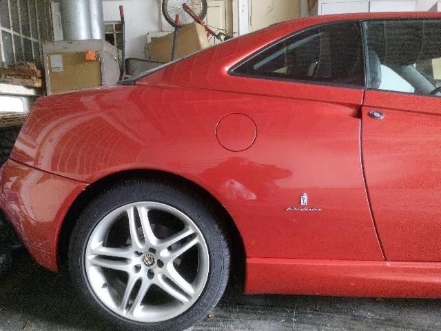

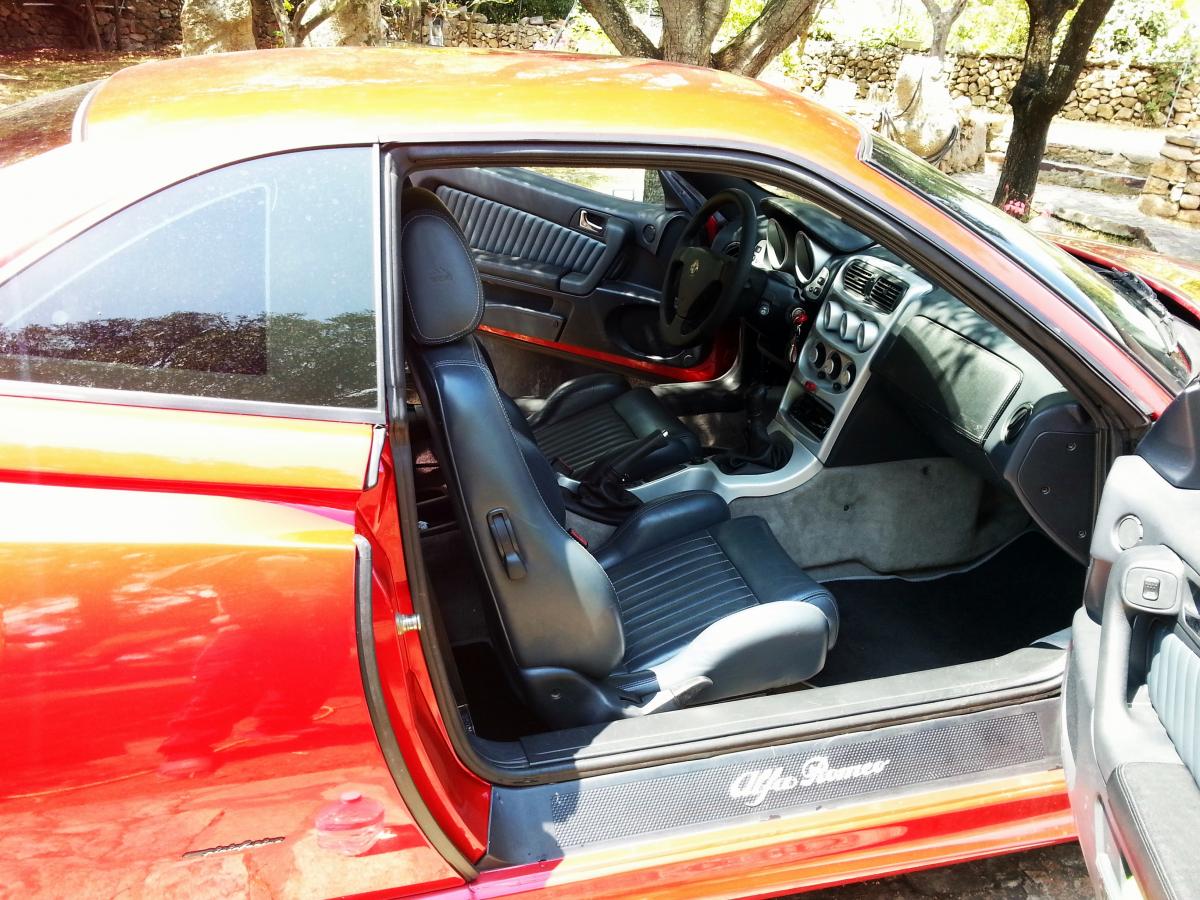

since it's a tri-coat paint reflects both the lights and can seem completely different depending on the lights. :) In some photos under the sun I saw that the color becomes almost orange :)
Wow looks fantastic!! Great addition with the cup kit
Ty :)

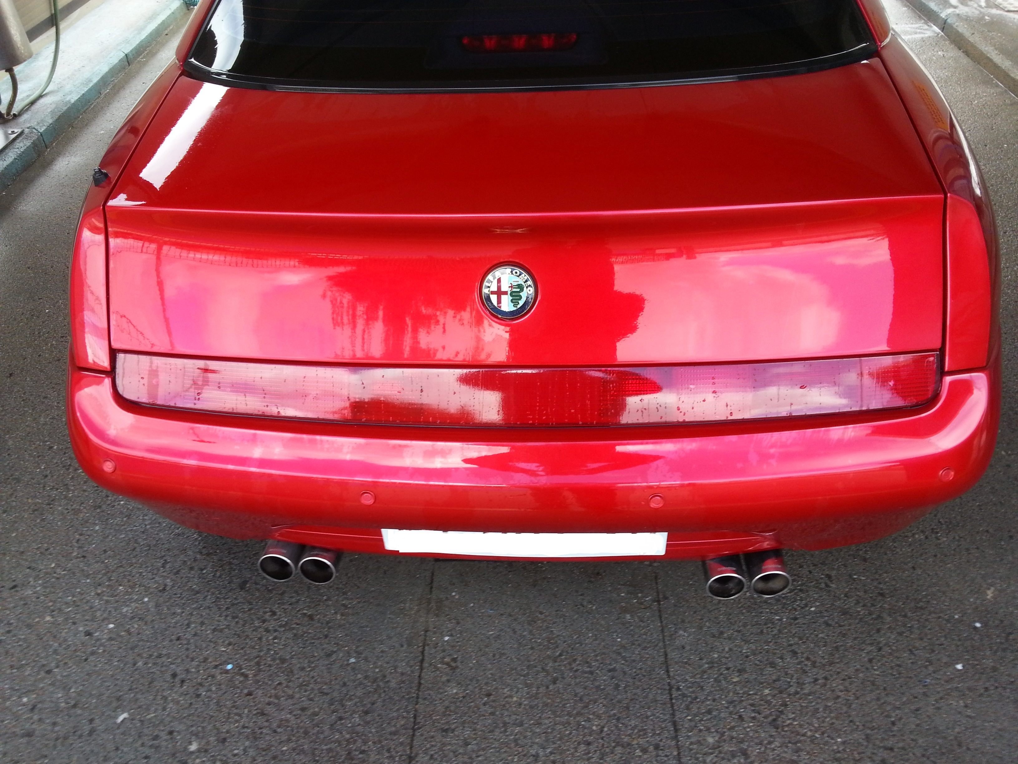

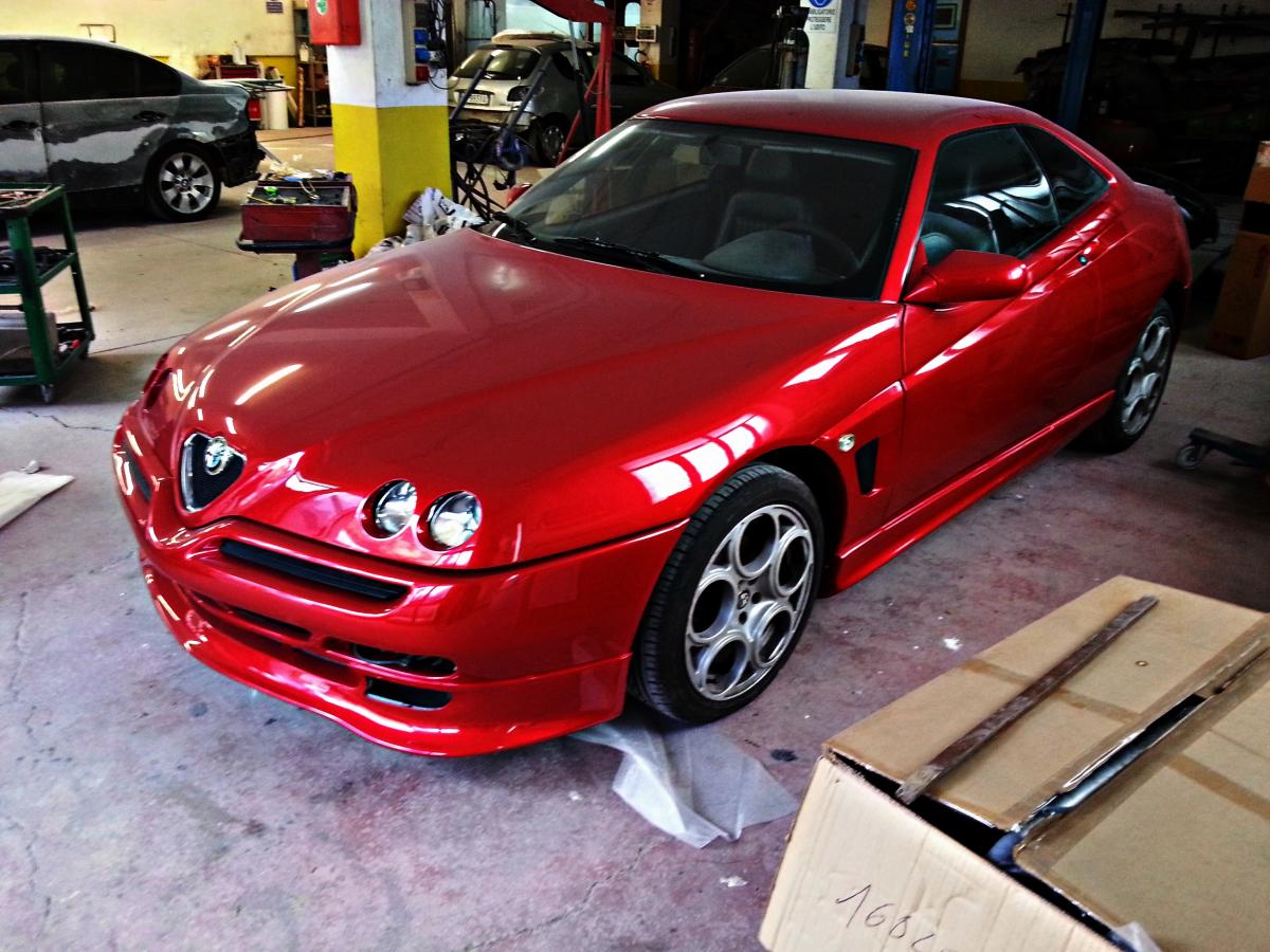

Almost ready ... is dirty and has to be polished....   :wub:
photos taken with smartphone and low light...
Edited by 916C-V6TB

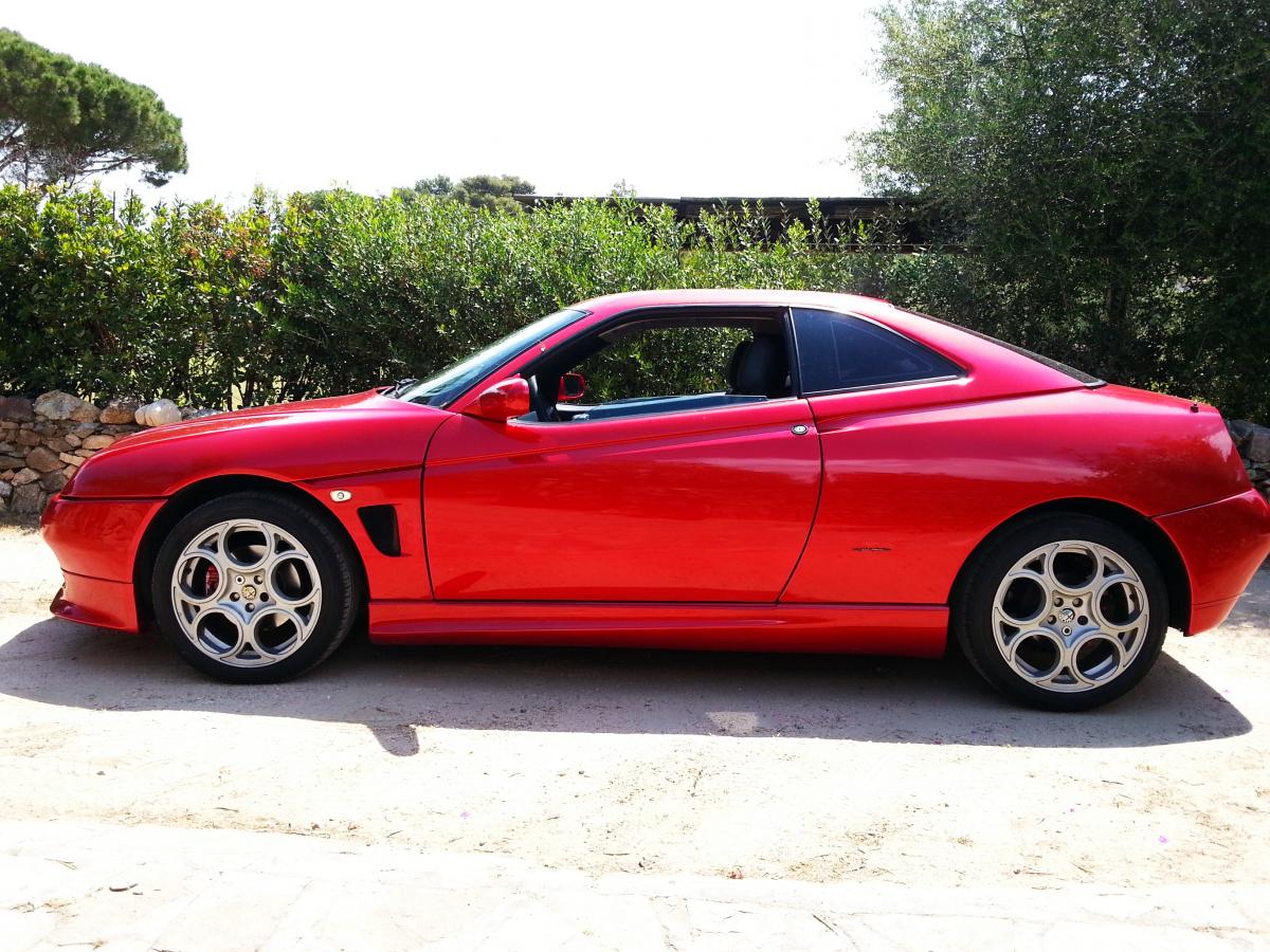

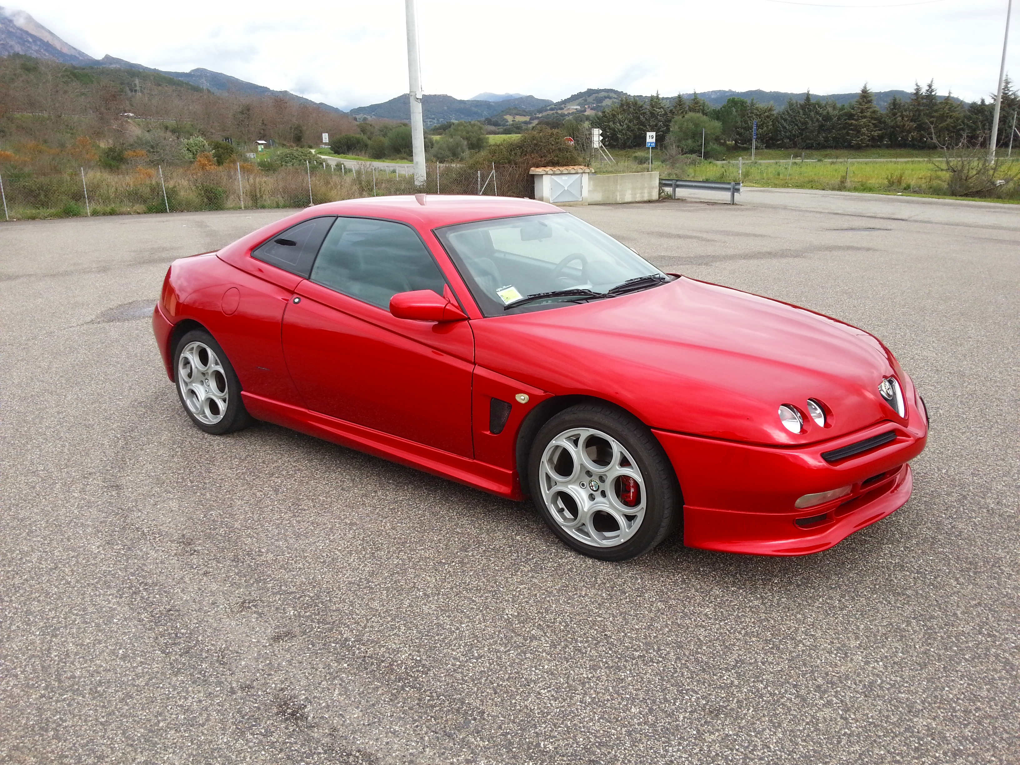

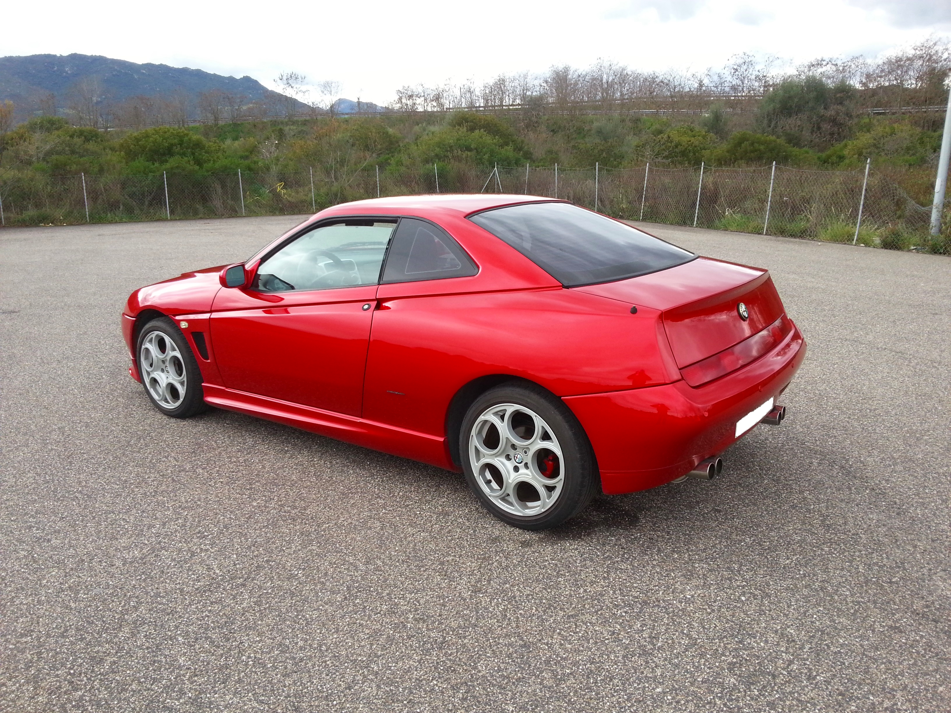

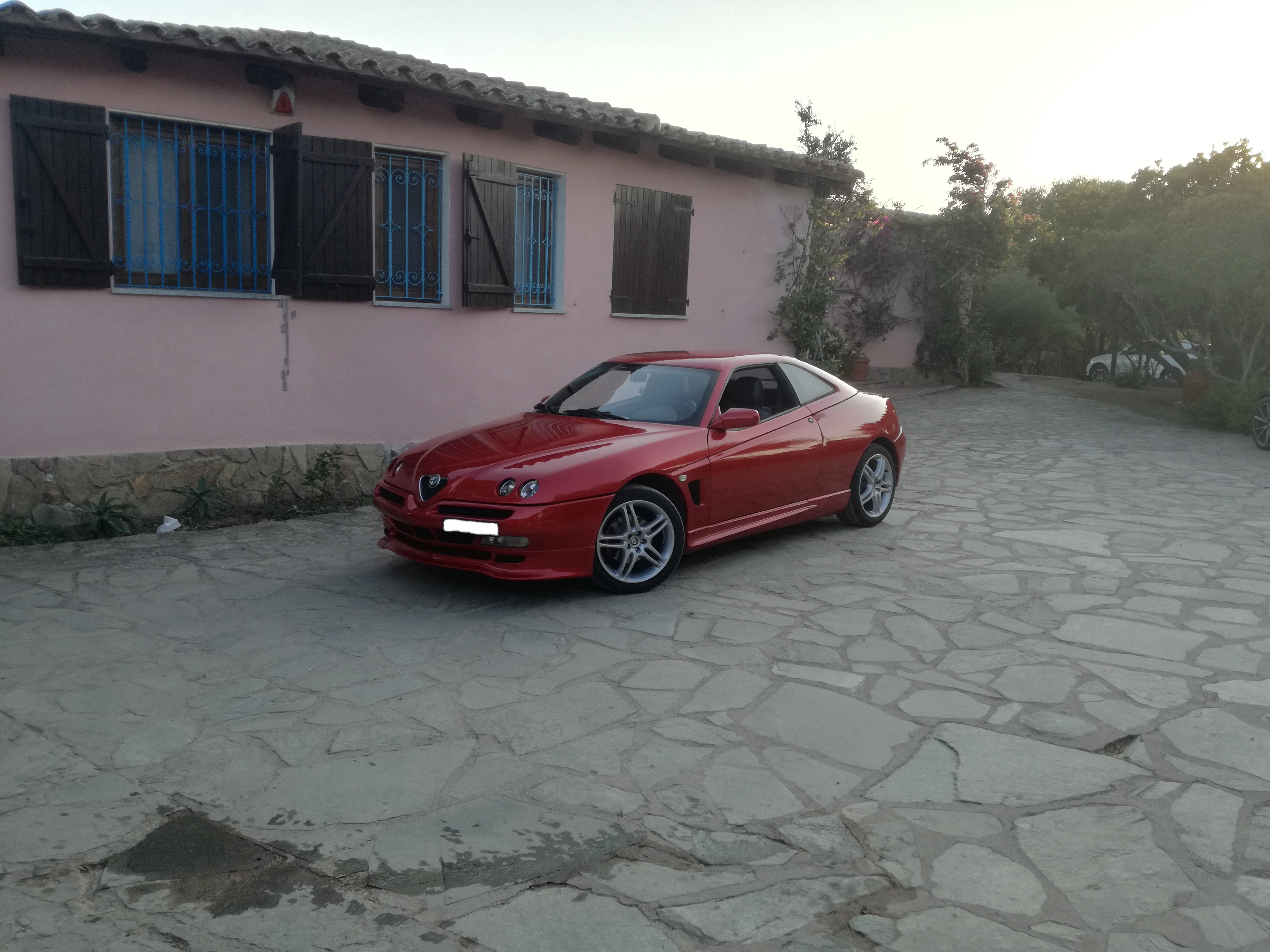

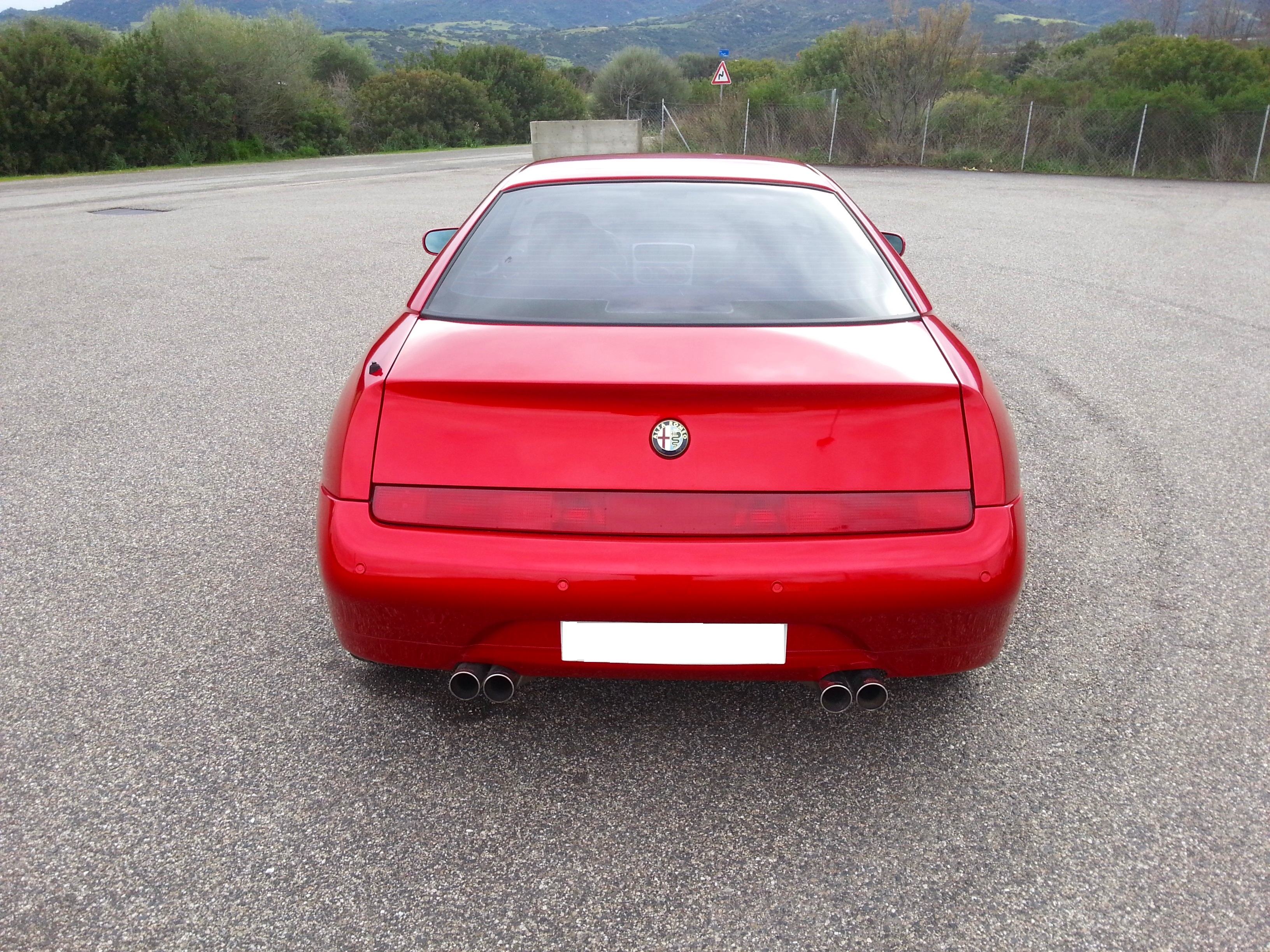

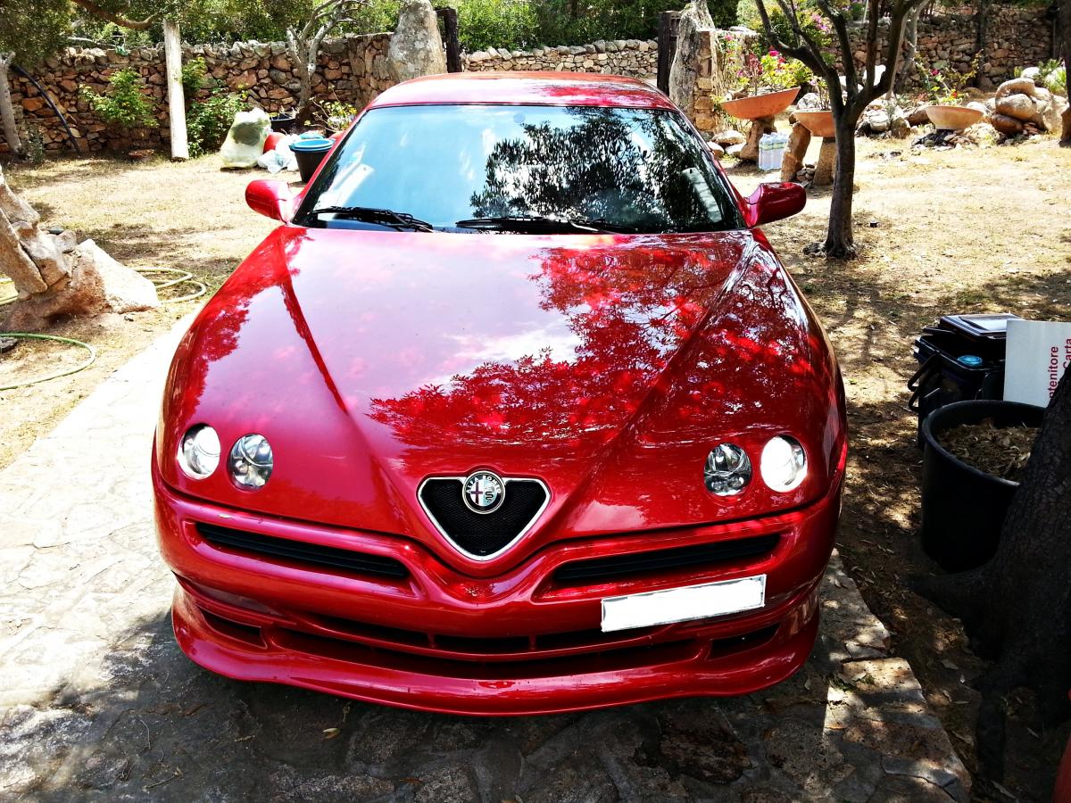

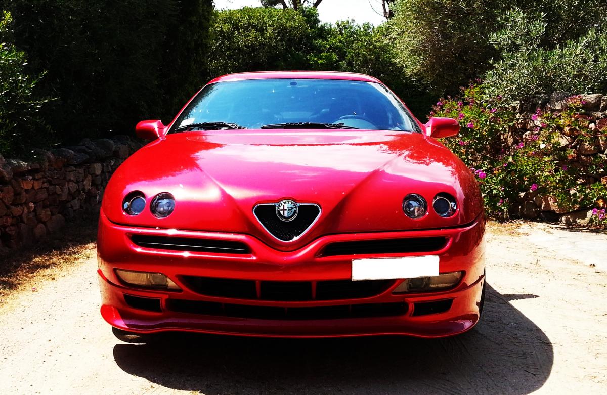

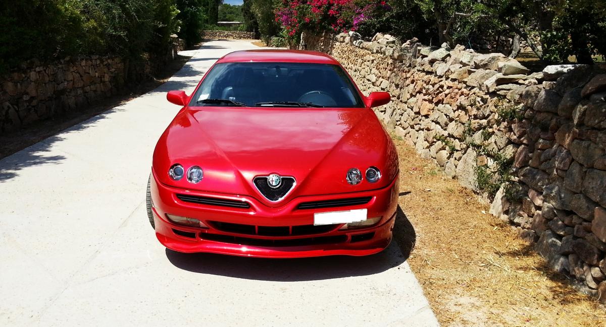

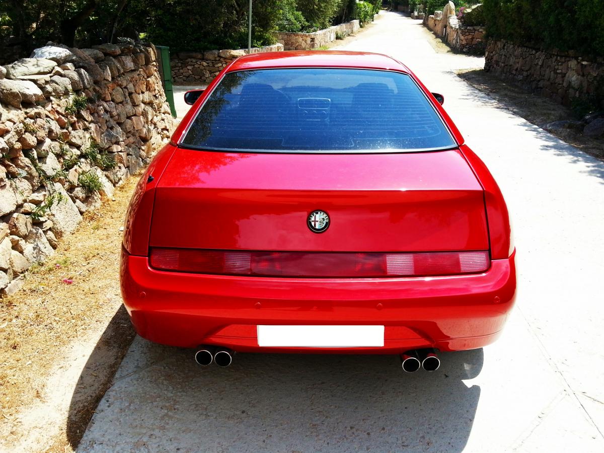

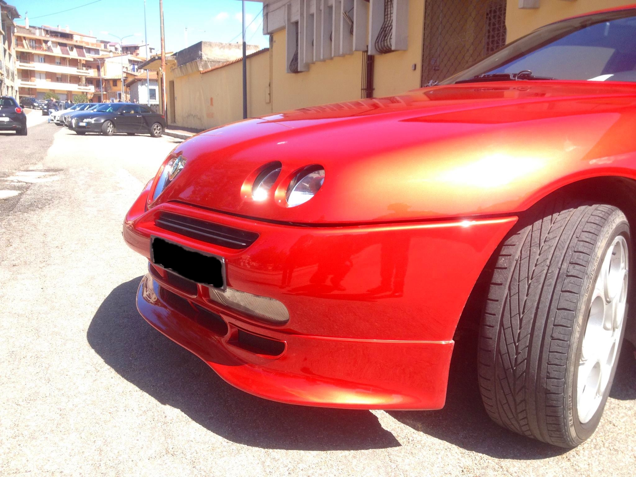

Finished works. Here it is :)
I am very happy with the result, I love it. :)
Now slowly we move to optimize the mechanics, starting from suspension. :)
ps pictures do not do the color justice... ^_^

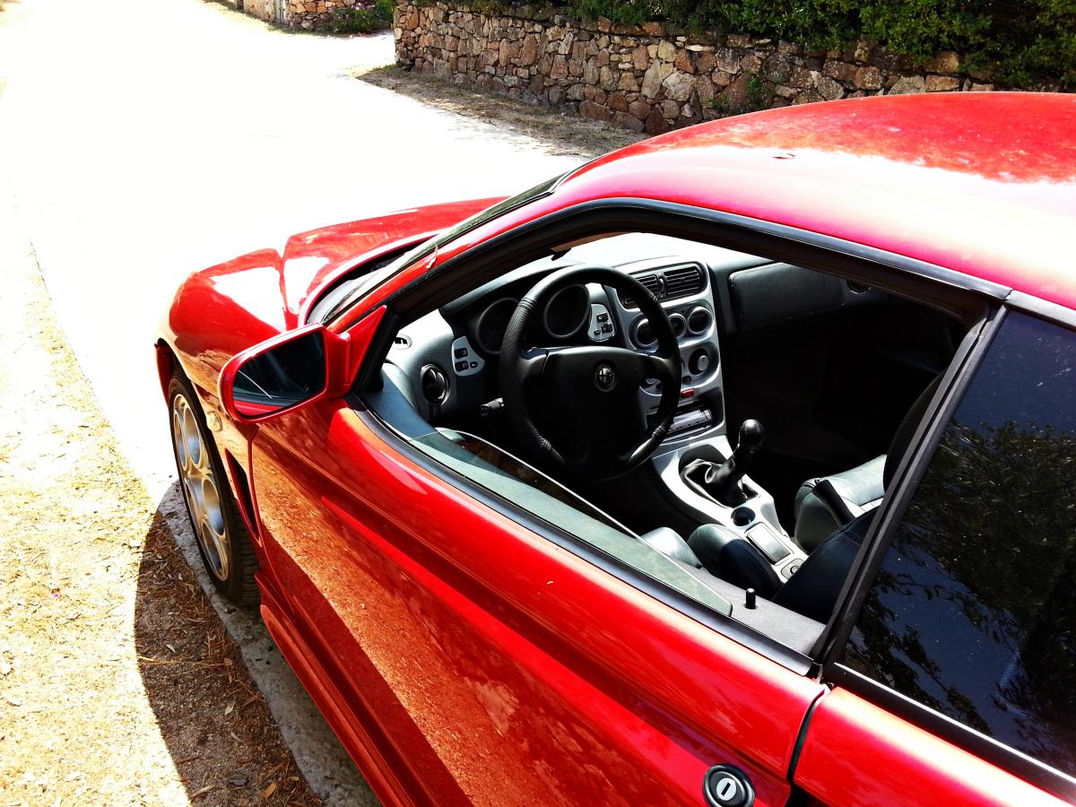

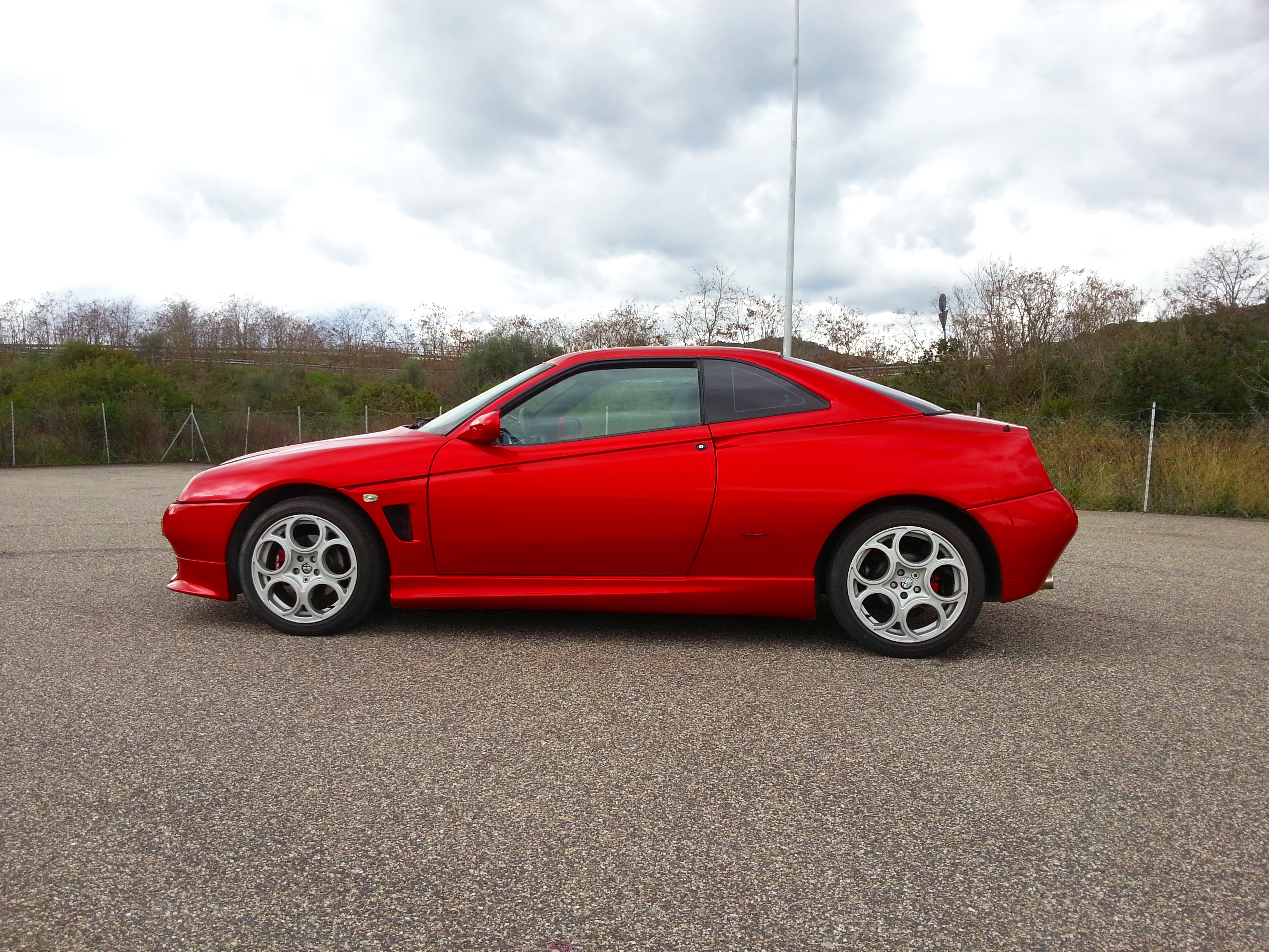

A little clip of my gtv in the sun :D  Watch in HD. :D

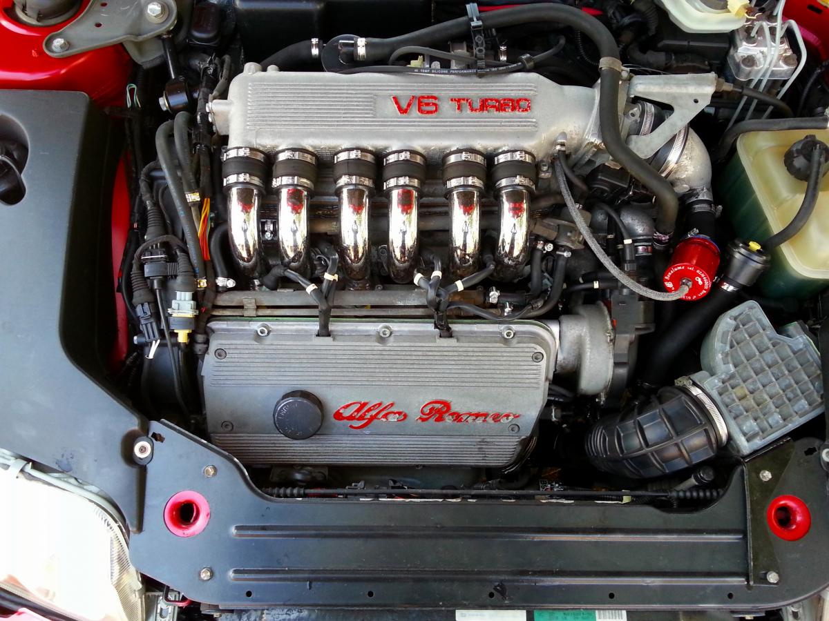

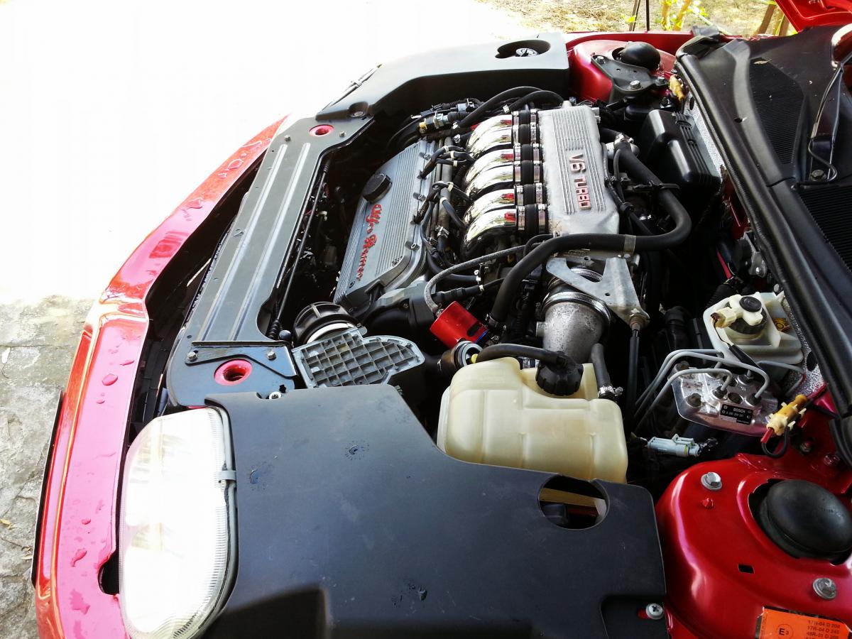

Great color! Word of advice, loose the blow-off valve. It makes a nice 'woosh' sound when you switch gears, but that is it. It does not make the turbo-lag any shorter, it even makes your top speed lower (the valve will start leaking more and more by itself in high revs, loosing power), and it only blows dirty, greasy air all around your engine leaving everything covered in grease... the TB's inlet system is way too long for a blow-off valve to have any positive effect.
Thanks :)
@JOWI
 I was already planning to take it off.  Also because it covers a little engine sound in
throttle release. I will follow your advice. :D

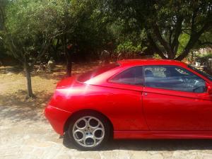

Great color! I like that you removed all the badges.
Now: lower it + spacers or original Teledials :thumbsup:
Thanks. I am going to buy Yellow Koni sport.  I have also already bought Eibach Prokit springs. But I do not know if install them, because turbo down pipe are very low and there is the risk of touching everywhere. I have 215\45 tires. I love gta wheels, prefer them to teledials. I'm looking for these in the pic, but they are very rare...  Spacers in Italy are illegal... :(
Those Phase 3 wheels should be still available new from your dealer. I bought a spare wheel last year. If not, there's someone in Holland selling a used set.

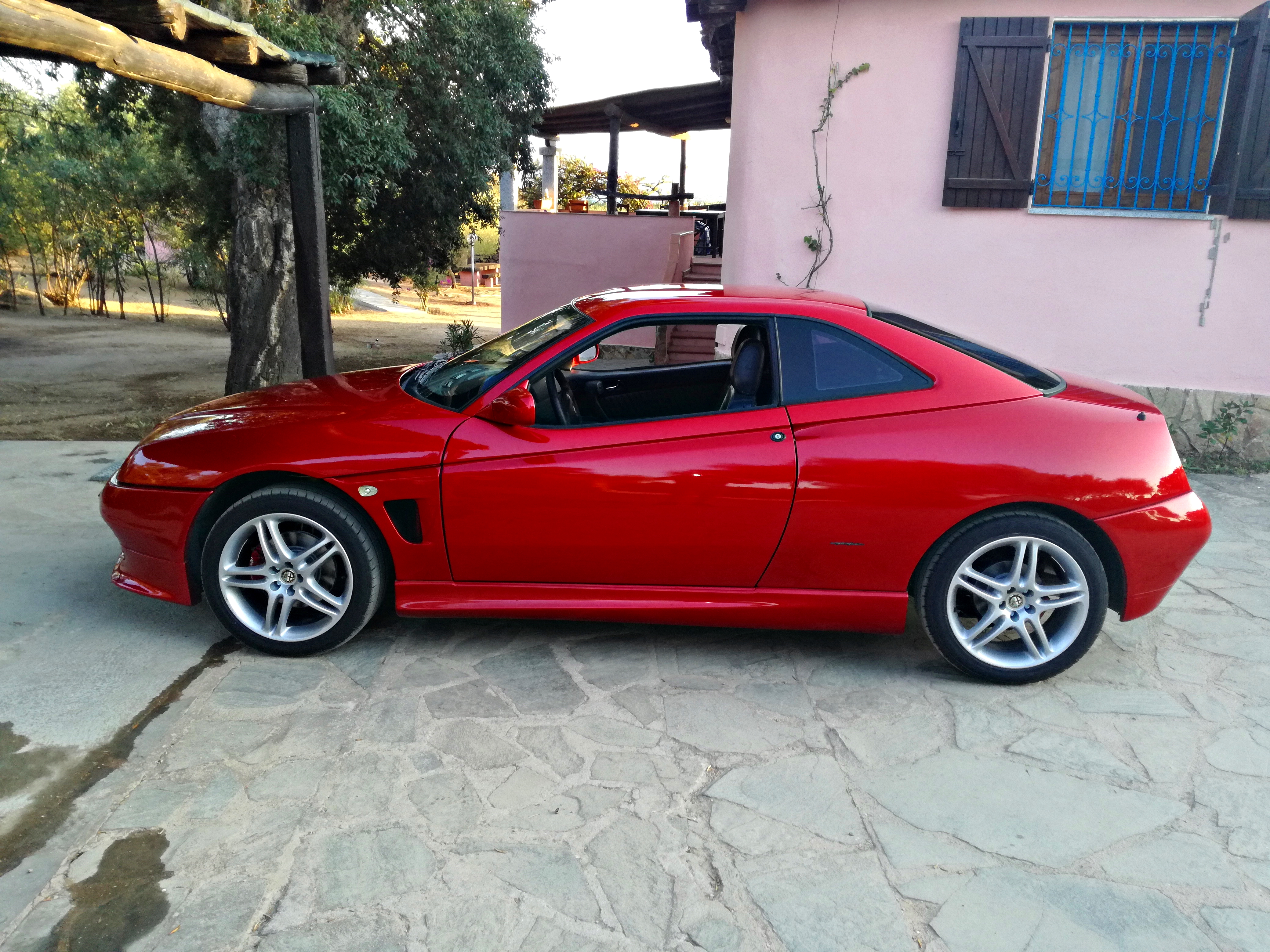

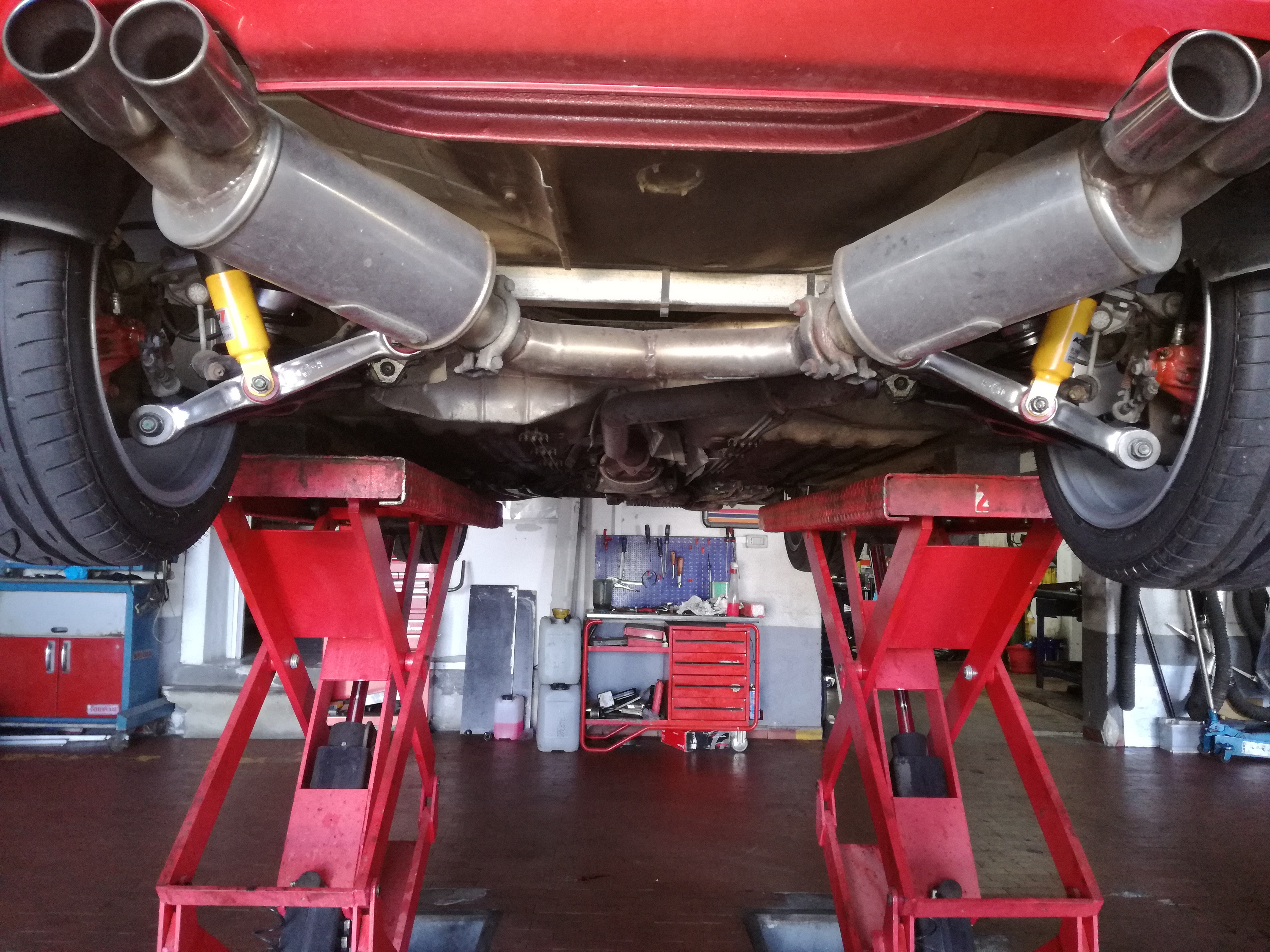

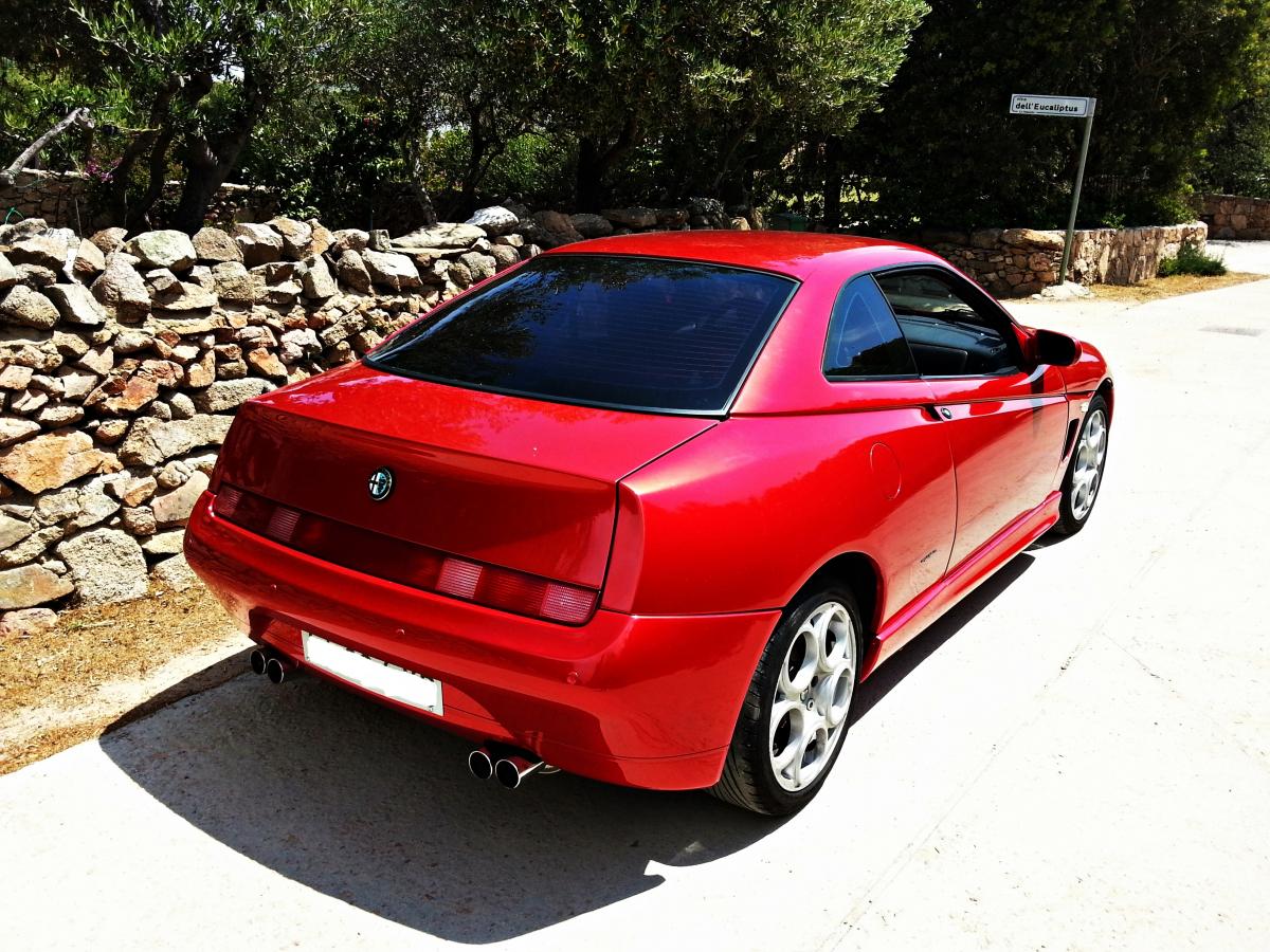

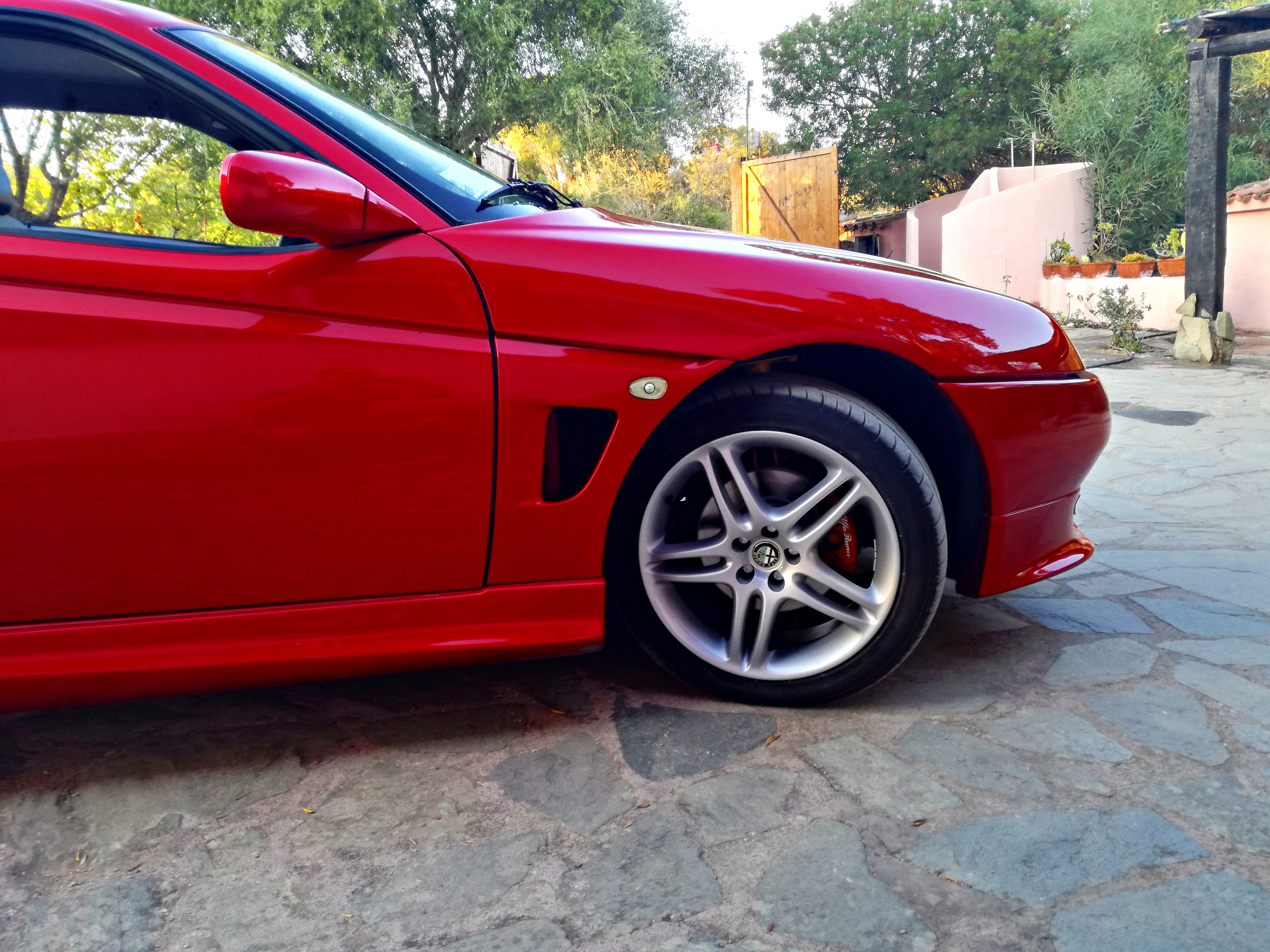

A few small updates.
New wheels with Bridgestone RE002.
Refurbished multilink with change of all bushes, Strongflex+Mercedes bushes.
New set of Koni Sport.
Full engine service.
On 26/8/2017 at 18:02, Thanos said:
Awesome!
Do you like the combo strongflex with the merc bushes?
Thanx Thanos. Yes i like it, for now they go very well. I did a few miles. The rear now follows the trajectories well. The Koni then are spectacular, it looks like another car than before.
