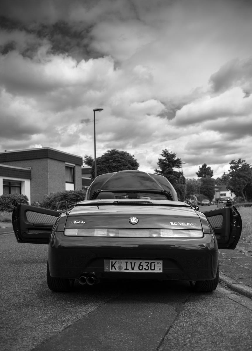

finally I've got time to show you my Mary: a spider 3.0 V6 24V elegante edition (1 of 241 pieces)
When I bought it, the car was already like new, but I spent the past winter to get a proper show room condition!

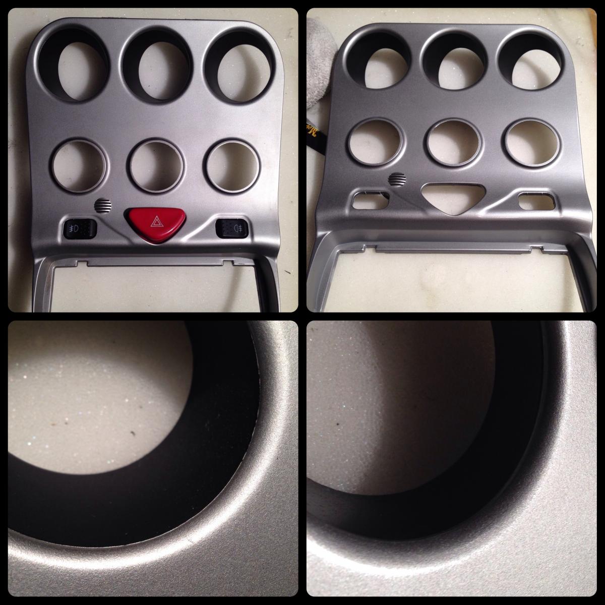

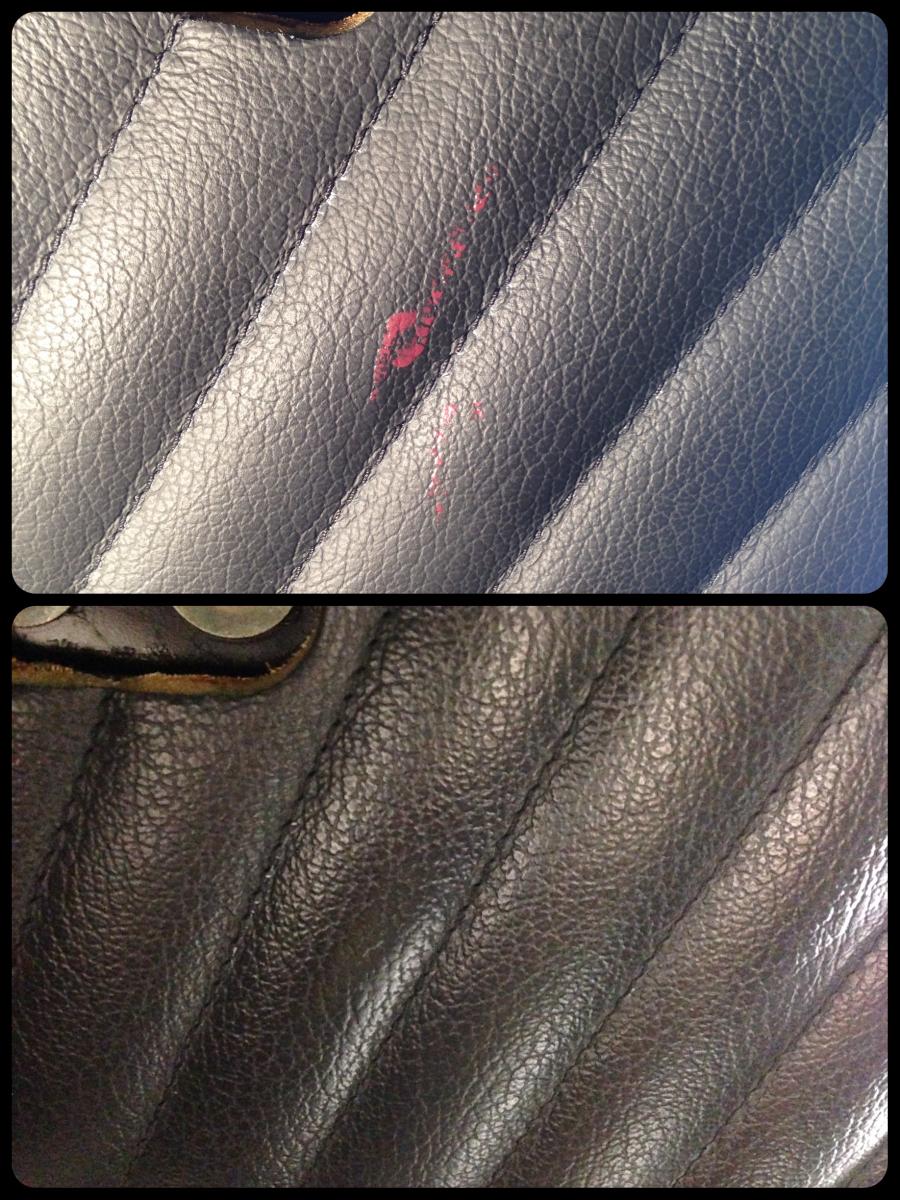

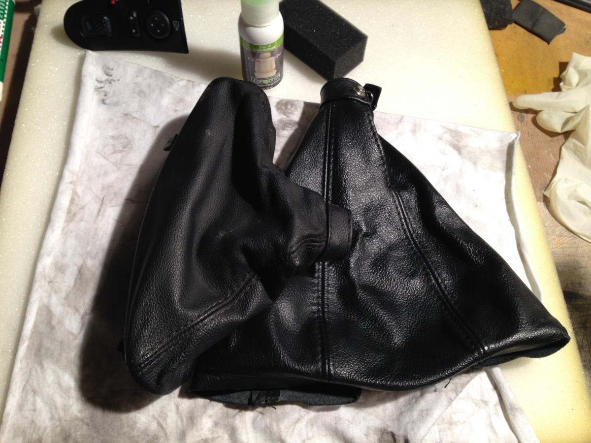

Starting from the interior, where some of the trim parts needed "love", some scratches on the plastic and some nail polish in a fancy magenta red on the leather trim...

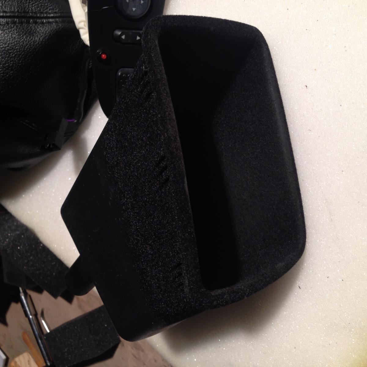

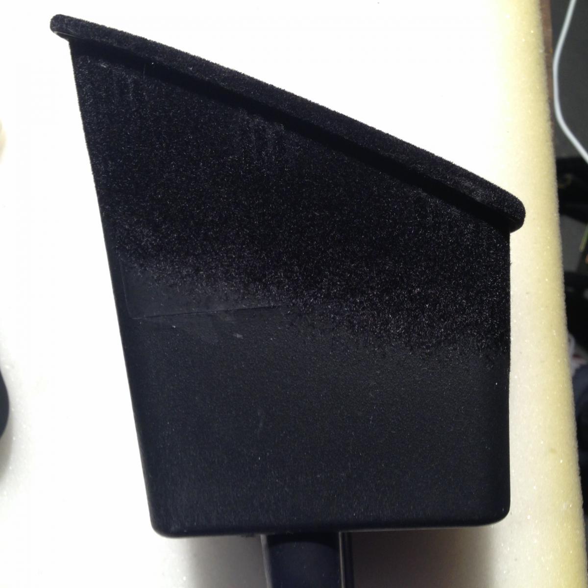

I've also reflocked the open box on the tunnel and revitalized the Momo leather with the original Montecarlo black colour...

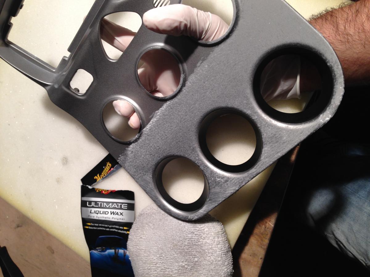

I've treated the center stack with some liquid wax and got rid of plastic imperfections...

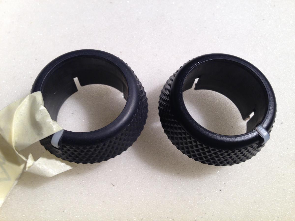

The rubber rotaries before and after:

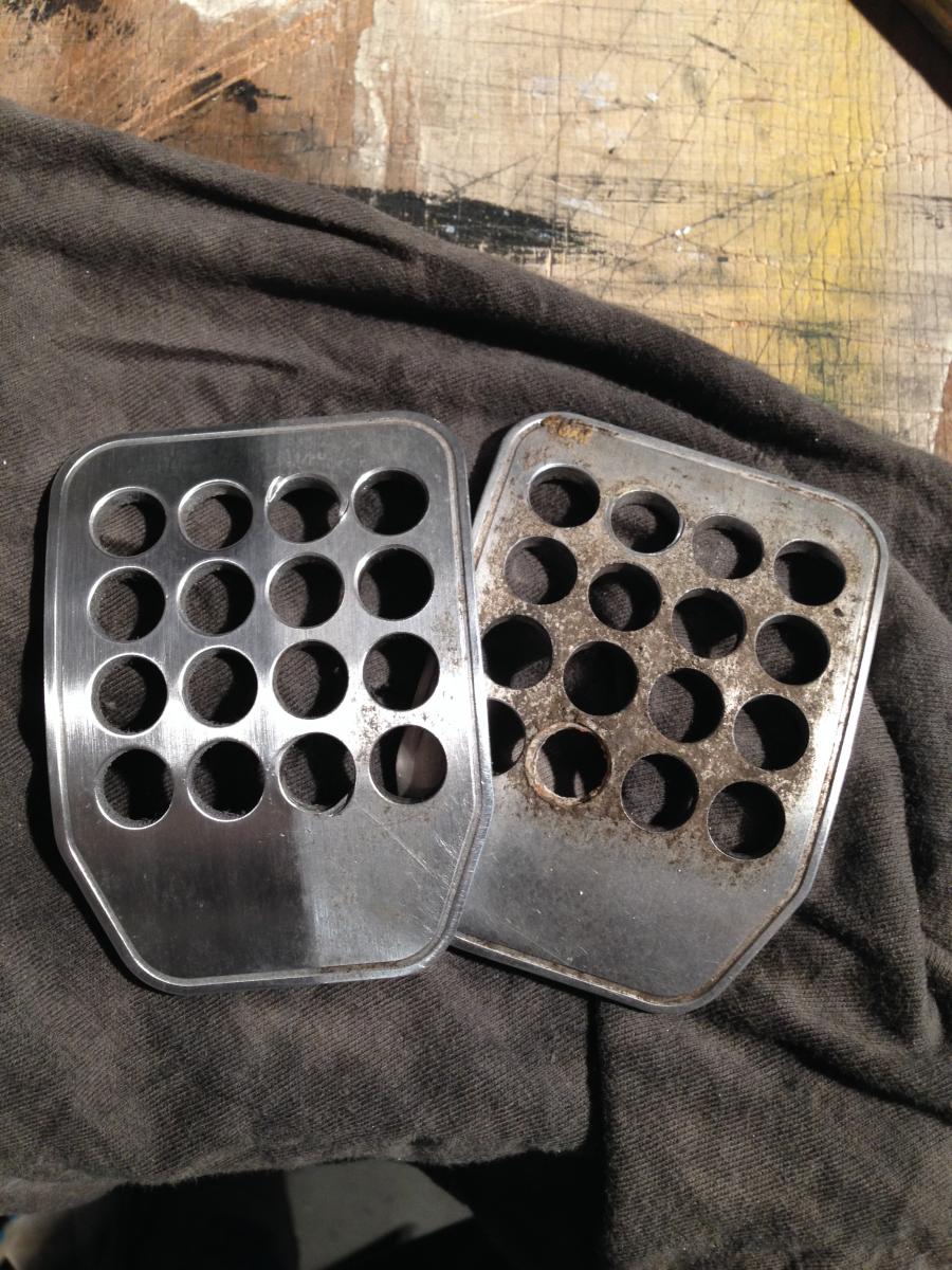

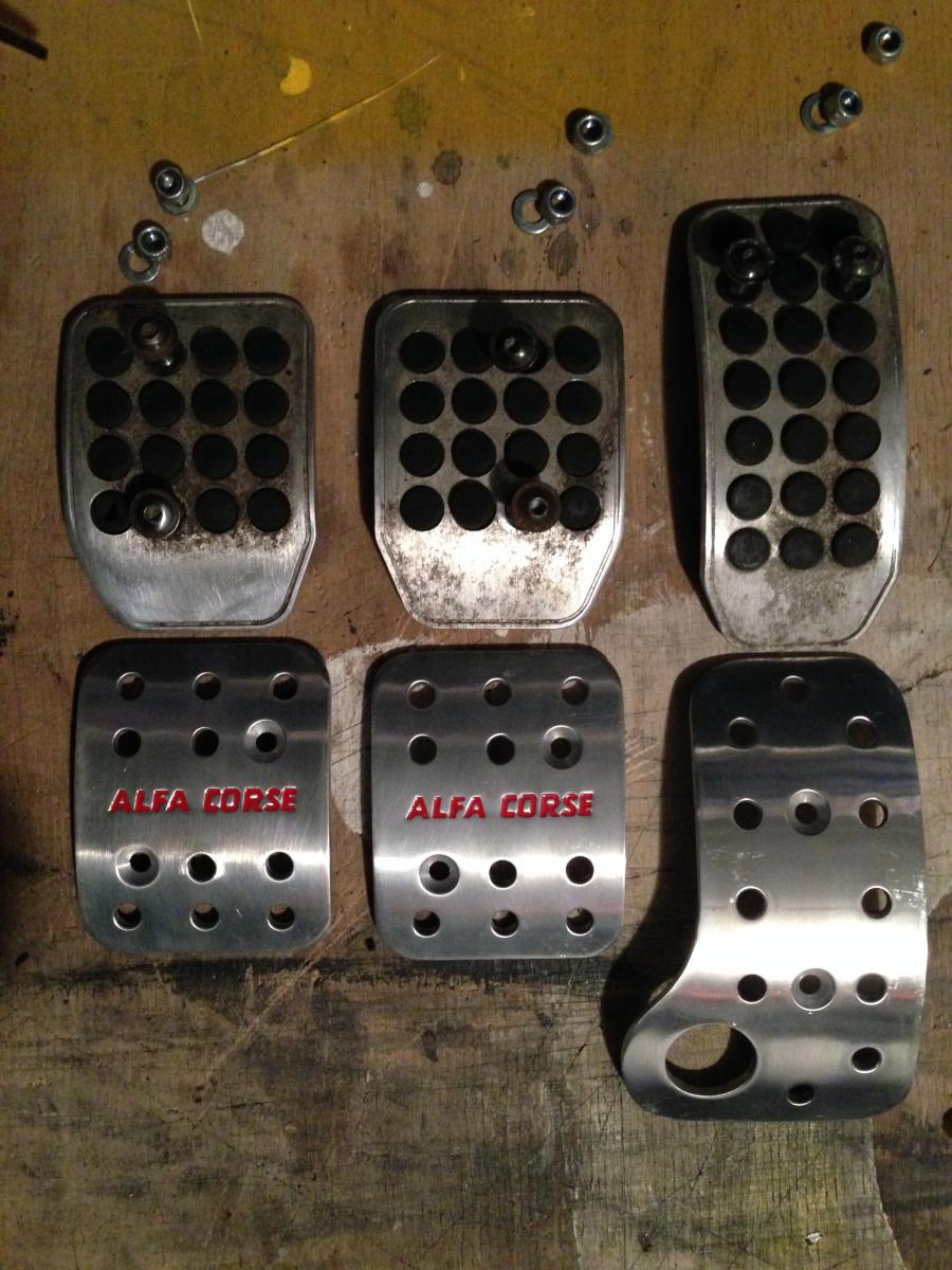

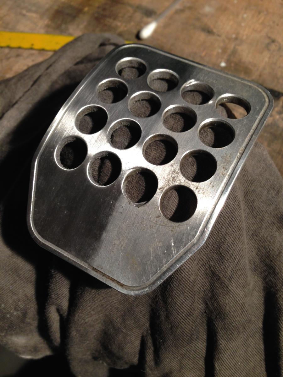

Then after a long research I found an original Zender pedal set and an Alfa Corse model... I had no sleep for a week, thinking which model I had to have in the car!... In the end I've opted for the Alfa Corse set, thinking that, after I restored it, the Zender looked too delicate, especially the rubber bubbles!

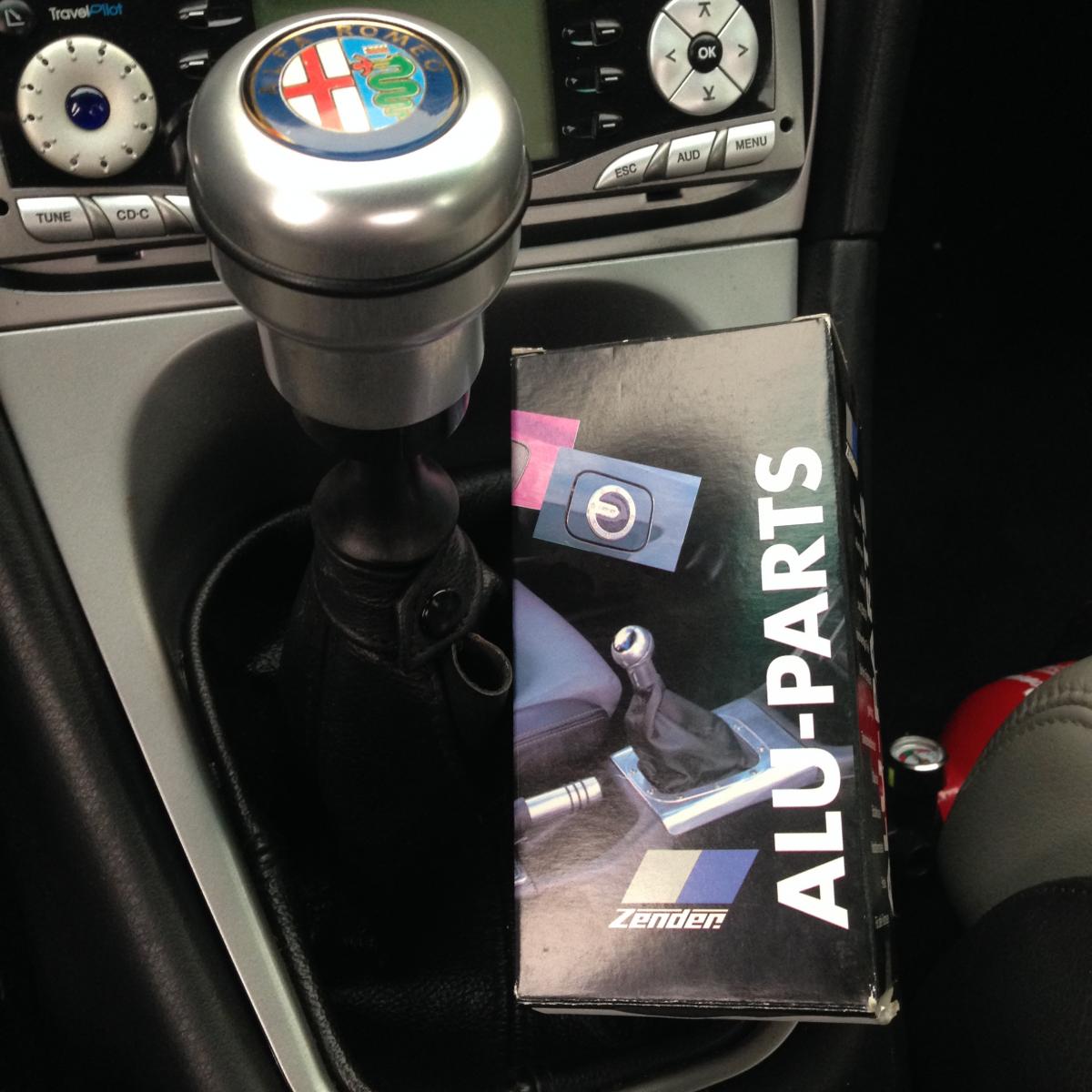

From Zender I bought a brand new shift knob.... that is still waiting for his brother "alu handbrake"! :D

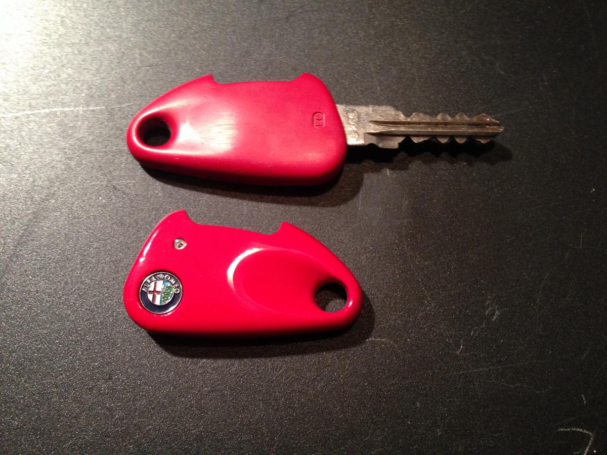

Also the key deserved a "deep" clean!
I used only a spit of Meguiar's compound that, in this case, helps to renew the self painted plastic parts.

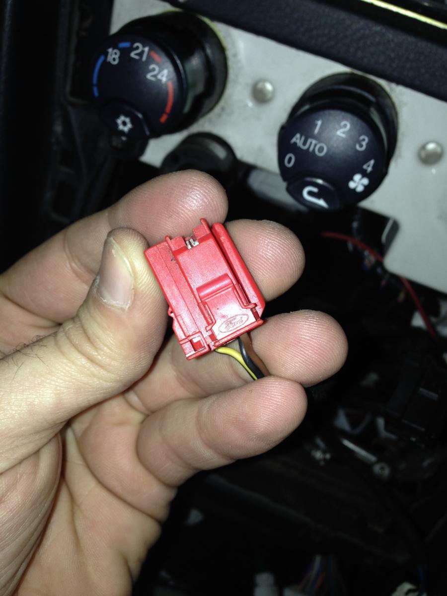

Still need to understand why this:
Is normal to have a Ford socket for the fog light switch? :huh:

Have you polished the plastic parts or just waxed?

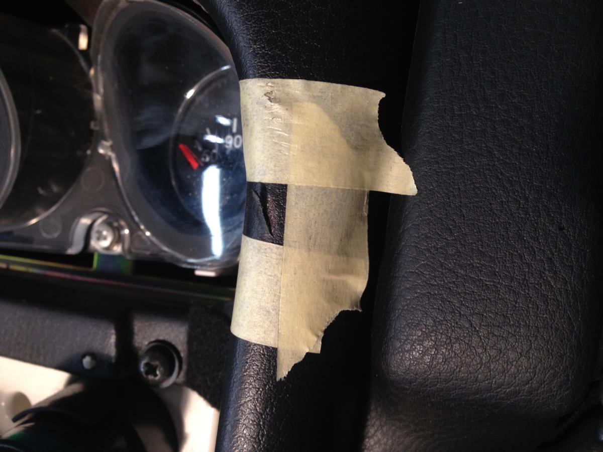

How did you repair the scuff on the dash?
For the hard parts I used nanotech polish, compound and then wax.
For the soft plastic parts I used meguiars treatment for dashboard and then wd40 to get the matt looking.
The scuff was on the frame around the center stack, so that means, if you want to change, you have to unscrew the whole dashboard!
So I first got rid of the excess then I used some filler for leather to fill up the scuff.
The result is awesome, hard to recognise.
Which leather filler if I may ask? :)
And one more thing, have you flocked that part yourself?
It's a kit from Oxskin... I can't find it anymore on ebay the Montecarlo black for Alfa but you can have a look here:
http://www.lederpflege24.com/shop.html
Yes I flocked it by myself.... I did a mess in the garage!
Edited by ivan
No I've just retouched the edges where the armrest touches and a bit inside.
Only for info, the flock colour is a glossy deep black.
