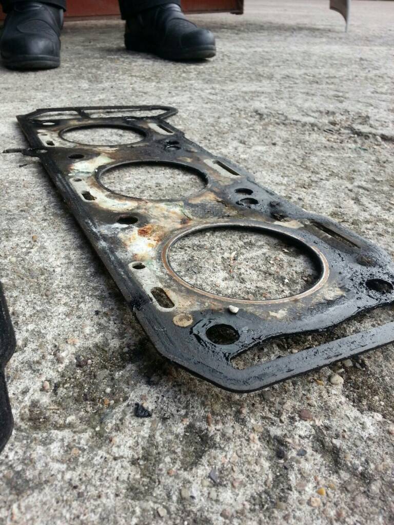

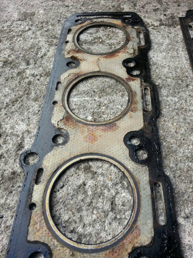

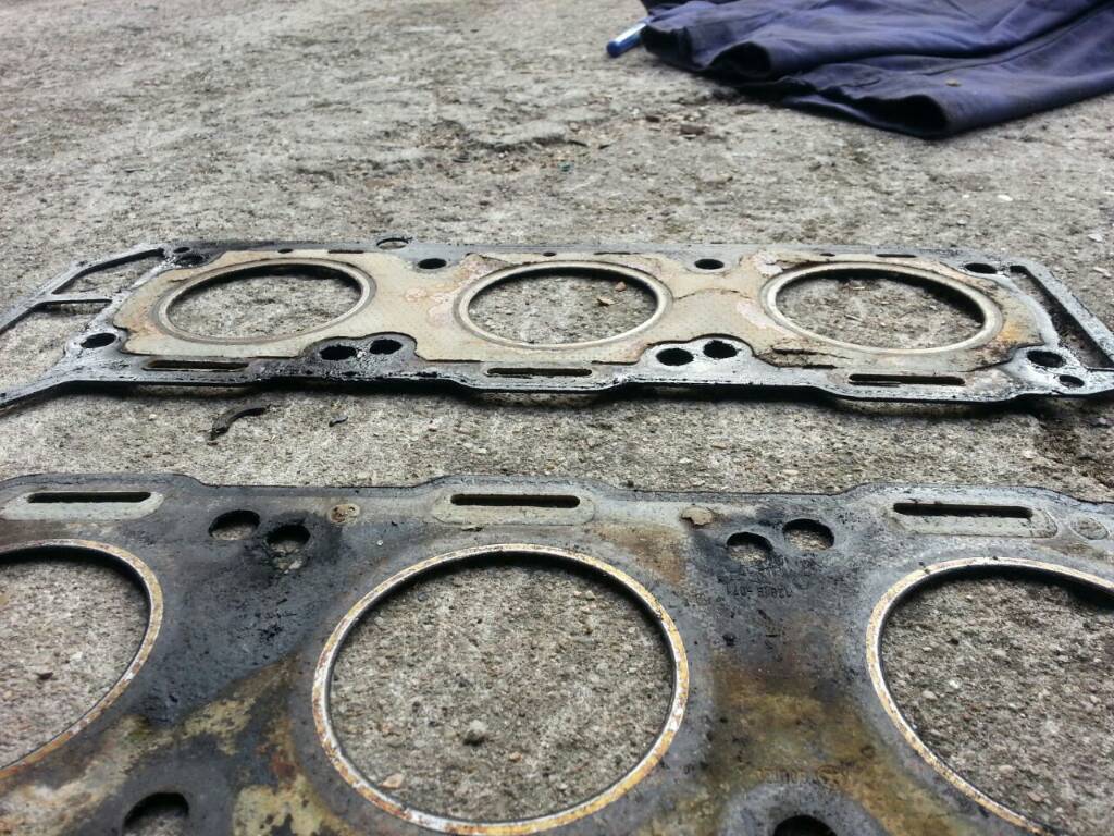

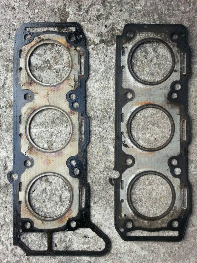

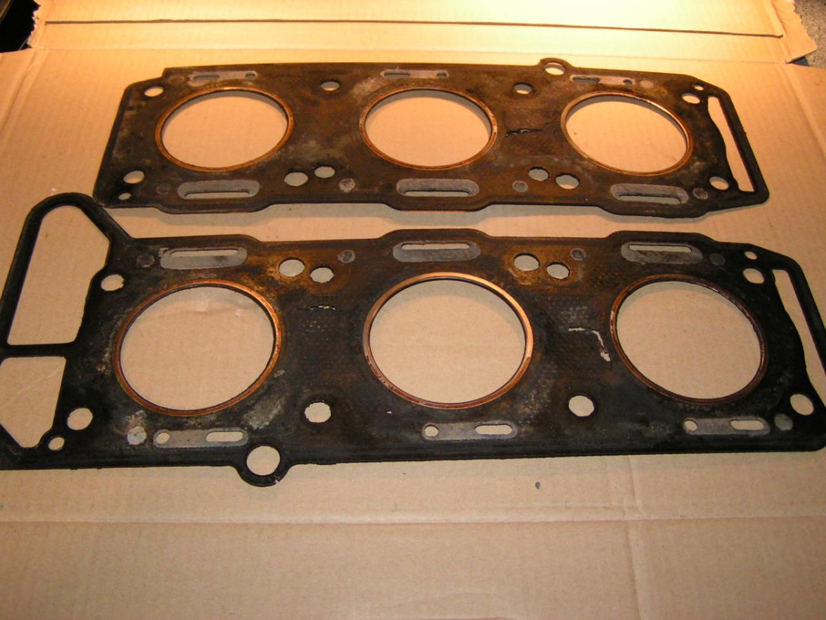

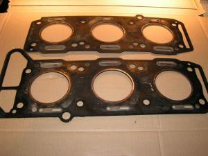

!!!!!! I'll have to take some pictures of the gasket I removed from the orignal engine of my spider which had smtg like 95000 km at the clock you'll be surprised!!!!! Compared to yours GTV-TB, my spider could have reach the 400000 km...

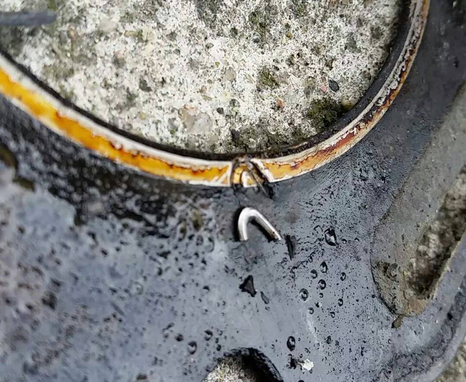

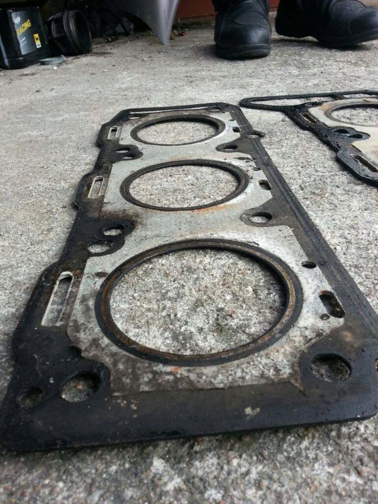

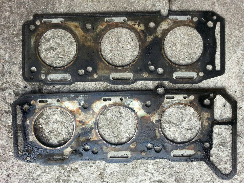

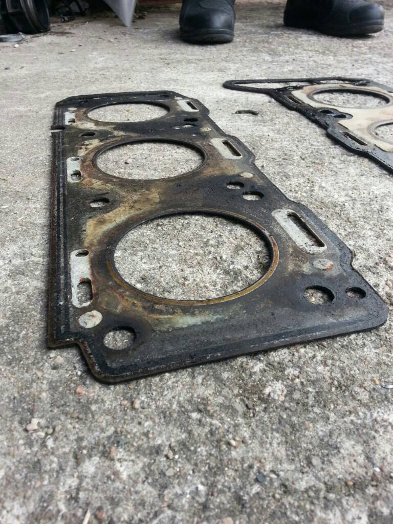

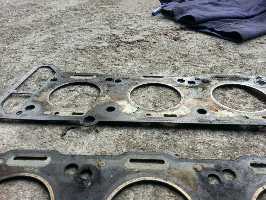

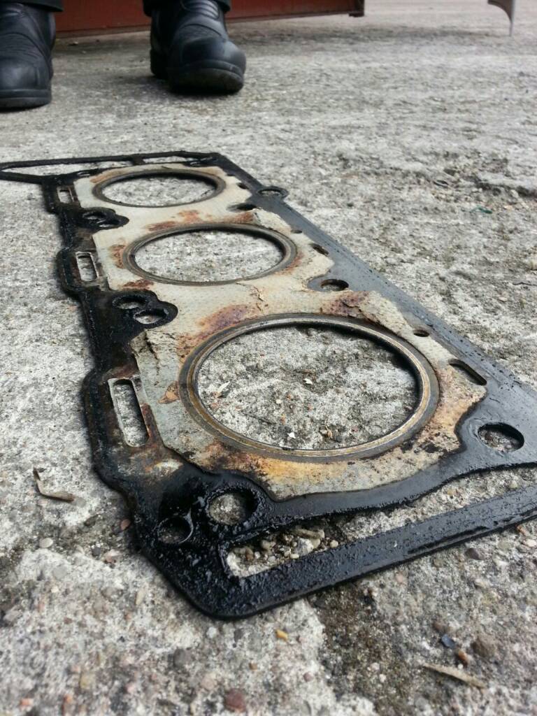

Here is two pictures of the gasket I removed from my noisy gtv TB engine... The gasket has already been changed by a Luxembourg mechanic...
Please do, and try to see if you can read out who has manufactured ​​your head gasket, my was manufactured by GOETZE.

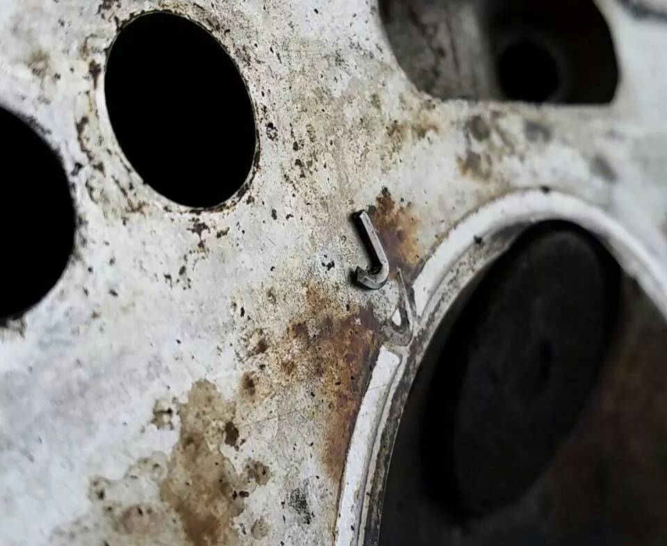

Hmmm .. foreign object is not good.
  On 9/1/2014 at 18:04, Damgreg said:
Cool :thumbsup: , also GOETZE I can see, and they have the same problem with the steel "backbone" rusting away as I had.
