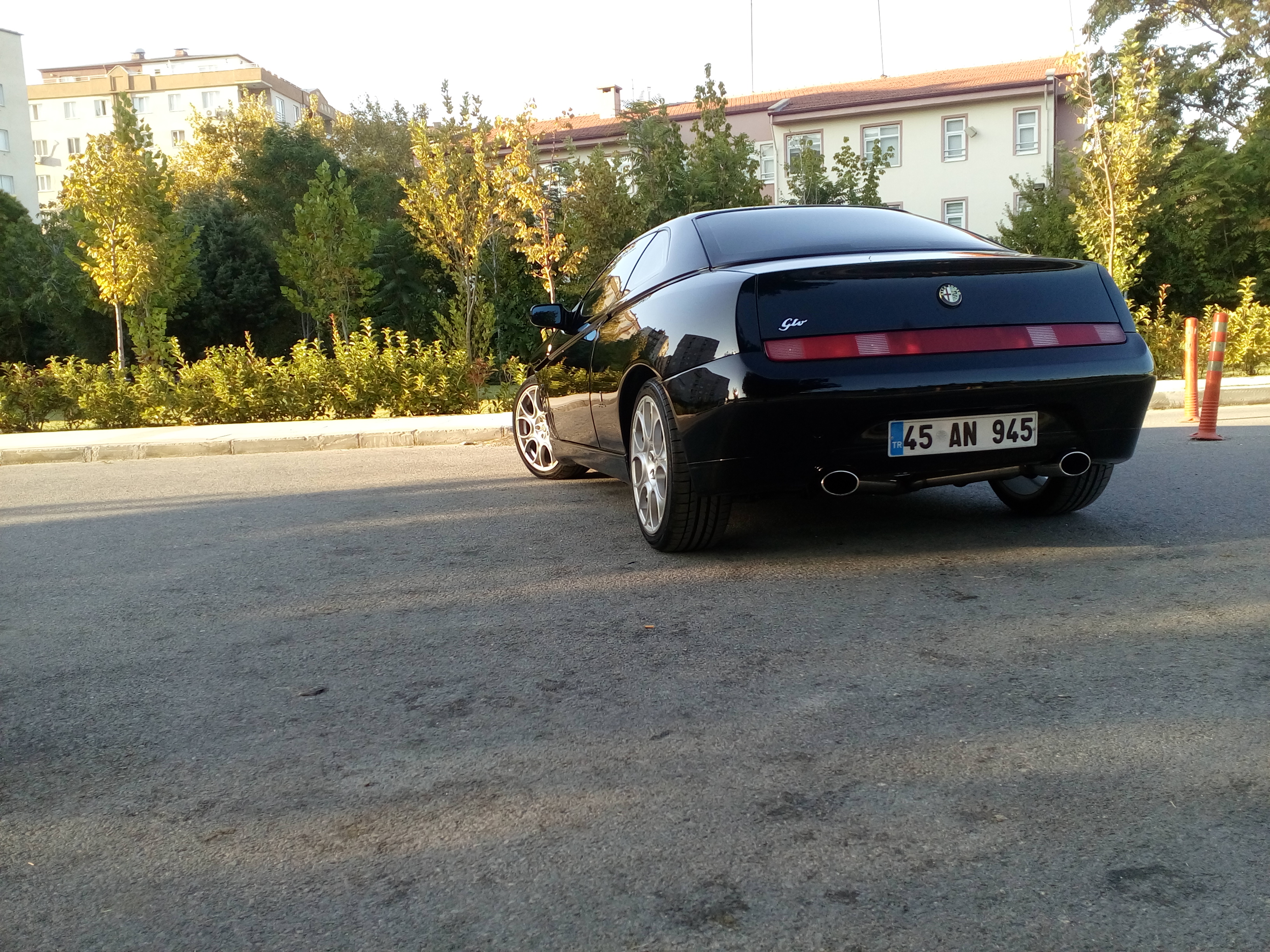

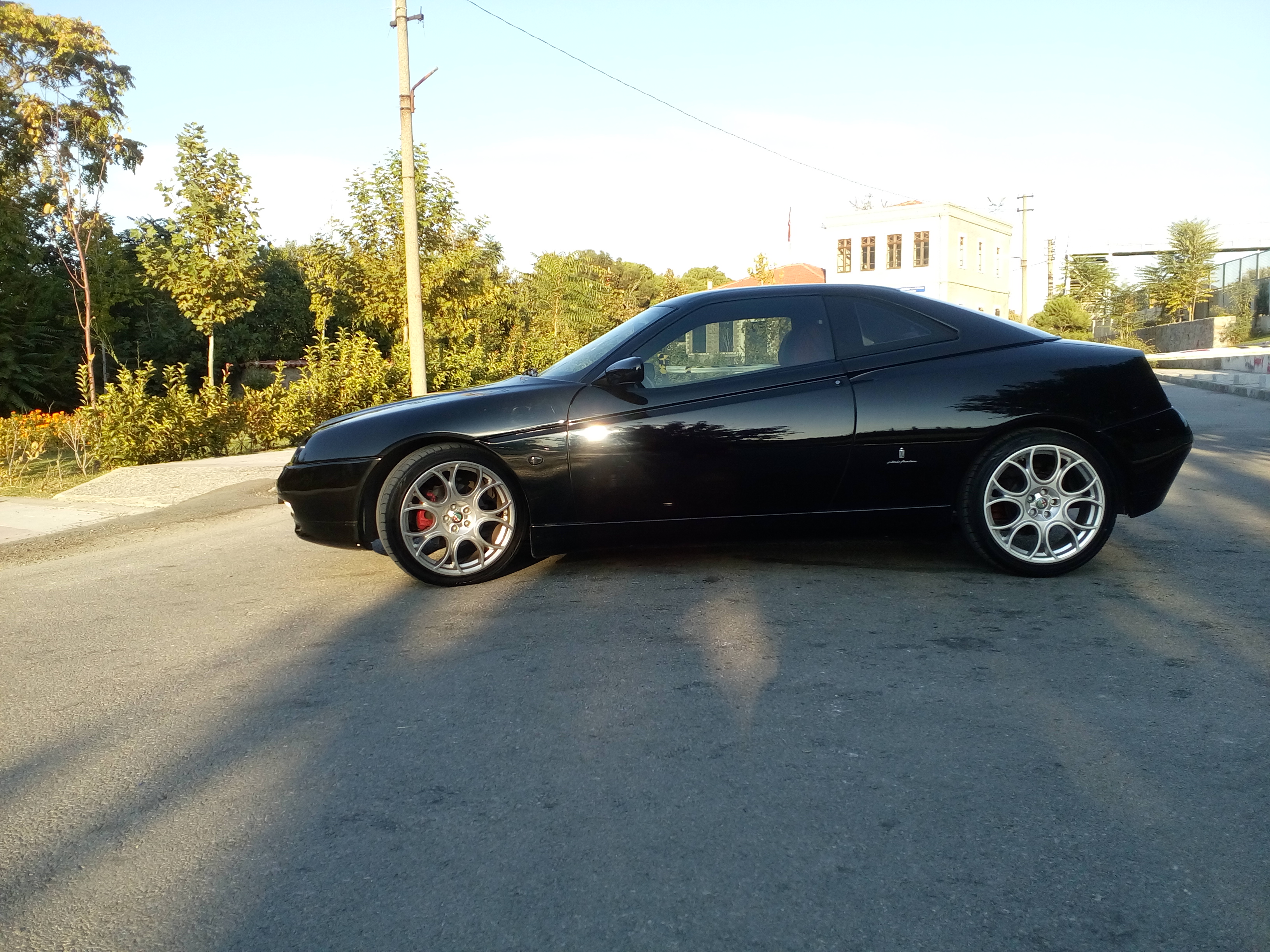

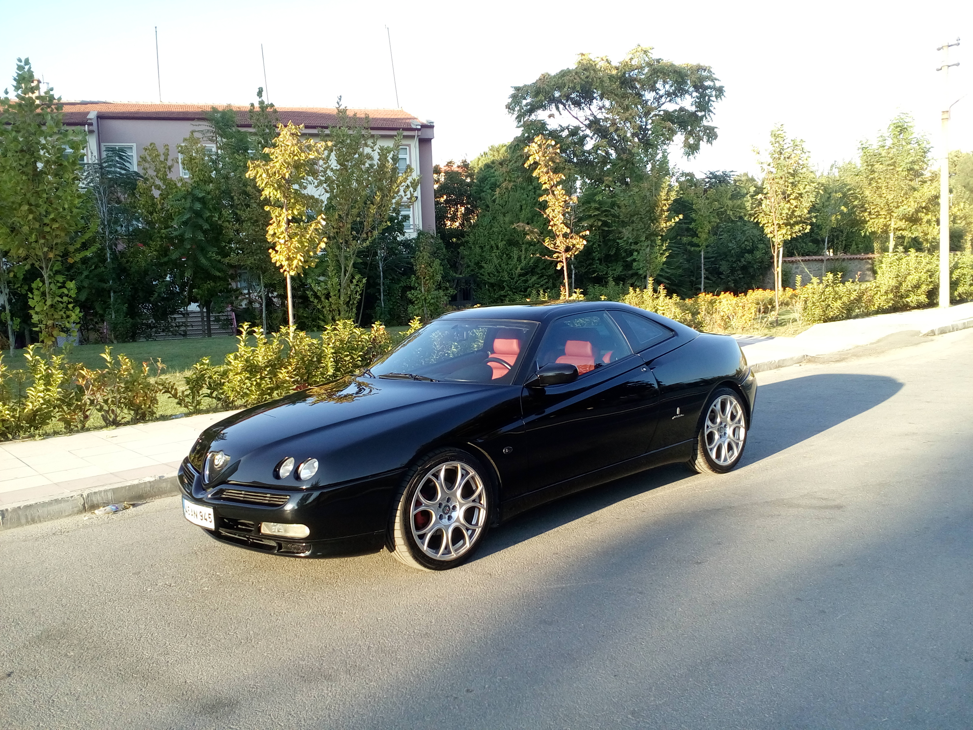

Hi guys...My name is Anil,34 years old and I live in Turkey. I have a 1998 GTV V6 TB. I bought my GTV four years ago and I changed all of sensors and electronics parts because of age. I modified some parts. My GTV condition was good end of the four years.
Engine;
-All car racing(Italy) chip tuning
-Pipercross sponge filter
- Exhaust tuning(removed cat., end of muffler and mounted sports middle muffler)
- Mitsubishi TD05 12B turbo
-Walbro GSS 342 high pressure fuel pump
 Shock Absorbers;
-Front Koni Sport Adjustable
-Rear Monreo Reflex
-Rear 20mm spacers
Brakes;
-Brembo Max pads and discs
17" Toora Alfa Romeo Alloy Wheels and 215/45 R17 tyres

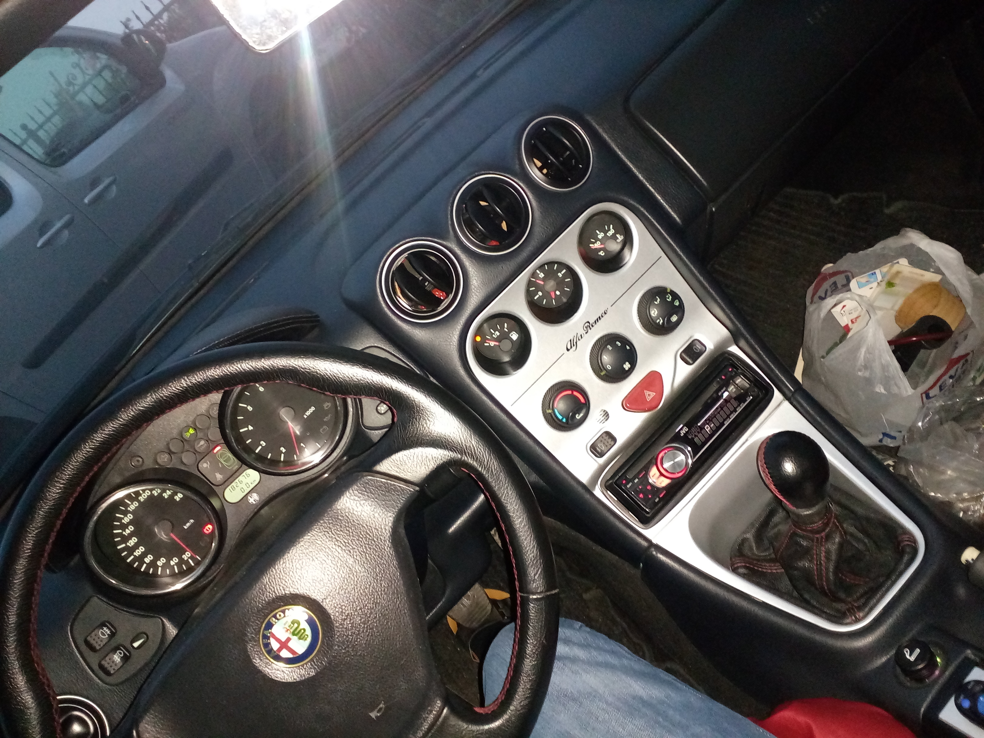

İnterior;
-Individual red leather seats
- Black leather-red stitch steering wheel and gear knob
- Mat chrome effect gauge rings
-156 air vents
etc......

Update with 18" rims, custom exhaust(inc. downpipe) and Ph2 interior...
