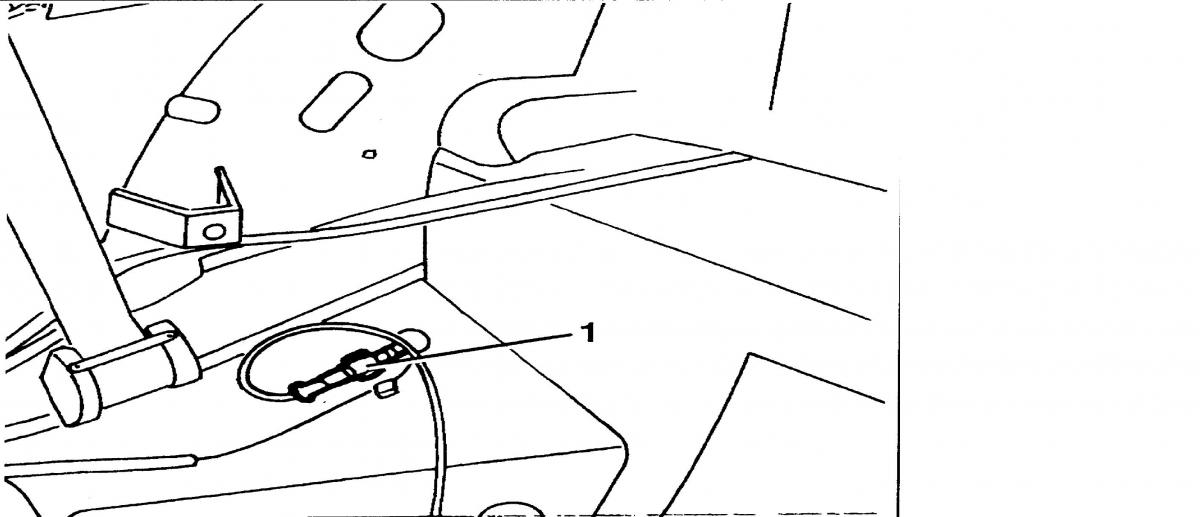

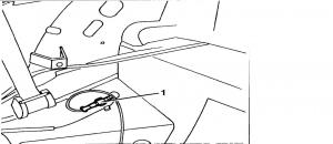

Anyone know where the rear ABS sensor connectors are located?
Crap... The brake line won't budge. :( Need a new strategy and maybe another tool.
 Or more violence. :bash:
 Remove the rear seat, remove the side panels, number 1 in the picture.

Great, thanks! I didn't get further than removing the seats and backrests because I was freezing my ass off :)
Now I know where to look, thanks!

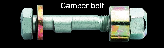

Why not use eccentric bolts like Monroe magic camber or similar, you get the possibility to vary the camber +/- 2-3 degrees (you will probably find a good setup there) and you have the possibility to even out L/R camber, and it will be cheaper.

Already bought Eibach camber bolts  :thumbsup: Haven't fitted them yet because the existing bolt looks seized as ************
