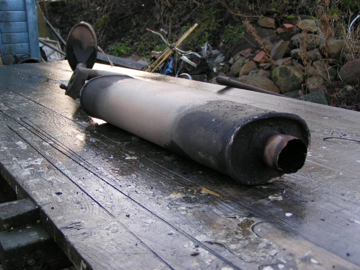

But I have road hump tuned my Punto :happy0045: , it sounds like a genuine Italian sports car now :ph34r: , a good substitute for the winter. :D
