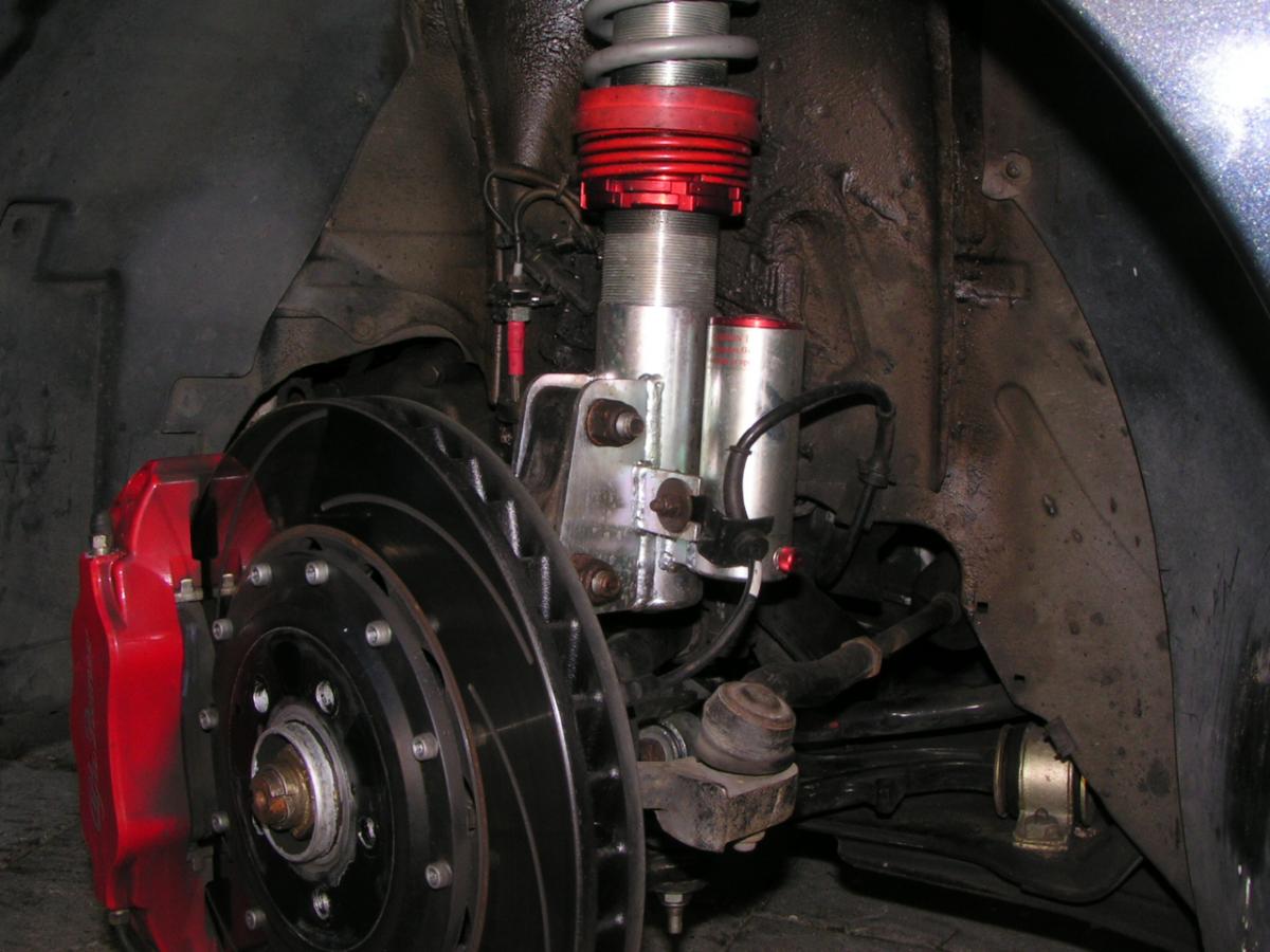

Will you keep on hijacking Filip's topic or shall I open a new topic for you? :P
Uhu.. hijacking.. he forced me :duel:  showed Boobs card so I showed big brake card. :)
We can share my thread  :thumbsup:
The one and only condition: More specs and pics of your TB! And mods you are working on and want to try. All the tasty stuff!  B)

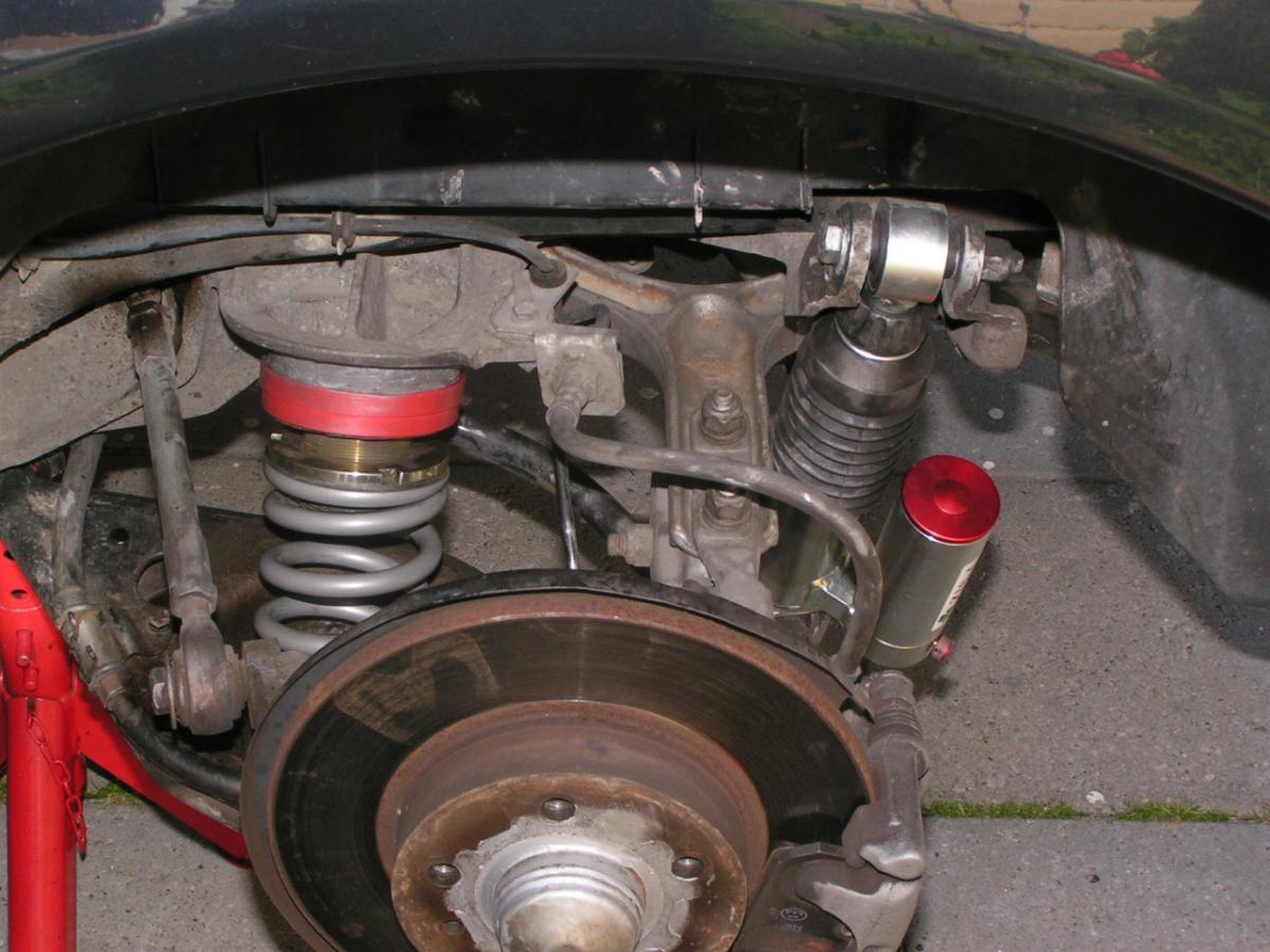

When Filip and I have shown our fronts :P  I show a rear end, nicely adjustable.
Aaw, I'm officially jealous  :icon_eek: (and look at that ugly emoticon... lol!)
Zeatek? Tell us more!
Even though I don't use a bra :giggle: .. the front end is still fully adjustable in height, compression and rebound are separately adjustable in many steps.

If you hadn't bought them and were in the market for a set of coilovers today, what would you buy instead?

Alfastumper is a funny man... He bought cheap chassis parts from a company called hotbits in Taiwan (I think), rebranded them to zeatek and then sold them for a higher price.
But you did get a good set for penny's!
It is easier for me to meet you in København than in the forests of skokloster ;)
I have FK silverlineX on mine, and it is well known yellow Konis with their own springs. I like the dampers, but not the springs. But it is still a lot for your money!
The TS has a lot more variety in coilovers than V6 models. See if you can get KW coilovers, as they use the same yellow Konis but again their own springs, witch I think is better!
I will try to ask KW for a set of custom springs on my car some time in the future!
I've looked at Hotbits, spent some time on their website. The DT2 kit appears to be the one that Alfastumper sold as Zeatek coilovers. Their price is 5600 RM, which is €1300, which is more or less what I payed for the entire car... So this is where FK coilovers get interesting!
