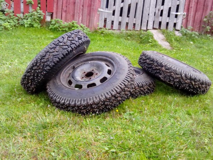

Photo of my latest "great idea" coming up :lol:
It's not pretty, but I'm looking forward to a lot of sideways action when it starts snowing  :ph34r:
And it makes my rat-race GTV look really nice, great!  :thumbsup:
Volvo ('jag rullar' / 'I roll')  drool.gif..........you need a new fart pipe on your car. :banana:
:beer:
I'm sick of exhaust problems  :bash:  ....
A set of winter tires for my Volvo is what I need!  :lol:
:hello: Not legal to use on the road. :(
Still nice!
I'm looking for a set of studded tires on alloy wheels, preferrably from the 242 GT or 244 Turbo...  :ph34r:

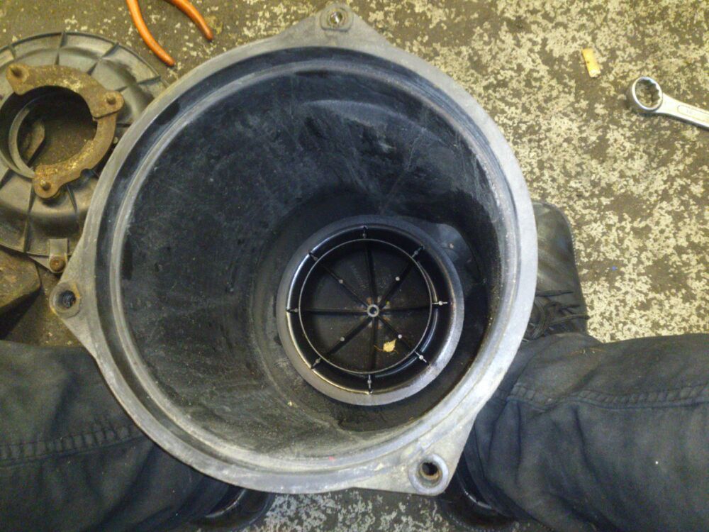

Can you guys tell if something is missing (apart from the filter, duuh :D ) on this OE filter box?
I drove in heavy rain a couple weeks ago and the engine started running bad/rough injection light flashing randomly, coughing and misfiring. It seems fine now tho, so I think it was caused by a drenched air filter. Maybe you recall that my car has an aftermarket cone filter that was just standing on the bracket with a sponge in between to keep it from rattling. Evidently my ghetto filter mounts mean that it's sitting too close to the ground when it's raining.
Solution: old filter box gets a second chance.
Can you recommend a drop in upgrade filter or would you go with the standard type? :)
OEM is equal than other style of performance (not really) air filters... If you keep the oem air box, put an oem air filter.
You can get a BMC air filter with a flexible hose, it's a good idea!
To me there is nothing missing in your picture. The cone we see deep in the box is at its place, the filter comes above...
Thanks guys!
I experienced the combination of heavy rain and an aftermarket filter... Will go OR just because I don't want any issues in rain.
Just what I wanted to say, really. Keep the priginal filter in there, works best. I would only trust proper airbox systems.
It bothers me that I won't get much of that meaty intake sound... And the stupid box and the bracket weigh a ton, but... It works, even in rain ;)
