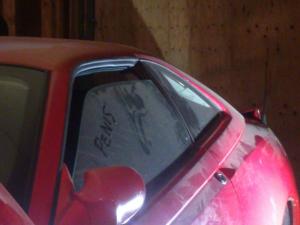

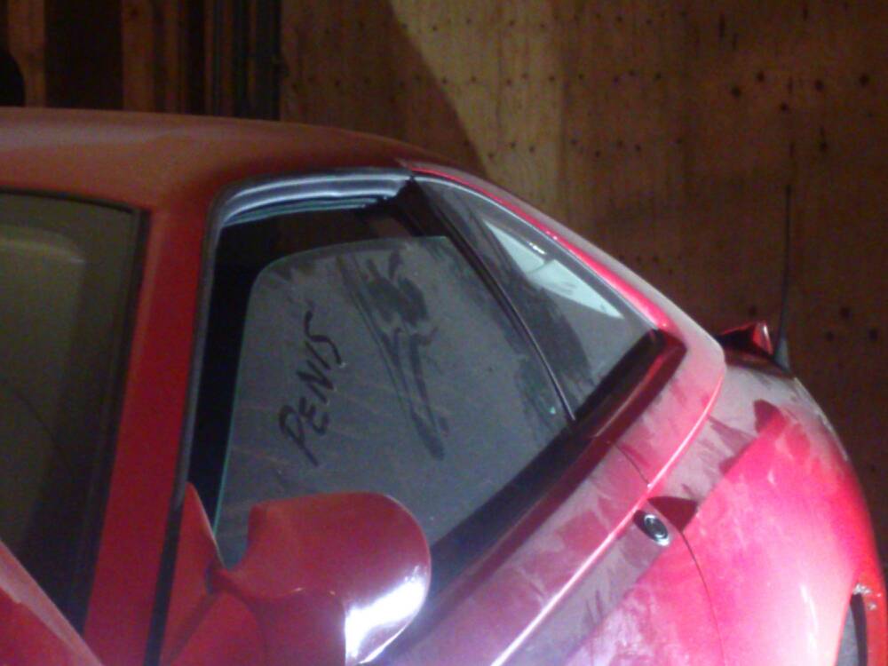

Is it so healthy to put on Biltema 36-592 on pytt i pannan?....isn't it a peculiar taste? :fear:
Are you pissed at the car?, I see that you have expressed yourself on the side window. :D
Hahah, damn it. BIltema stuff all over.
