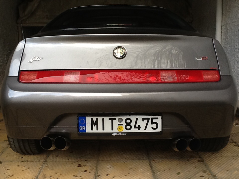

Butt is now rebadged.

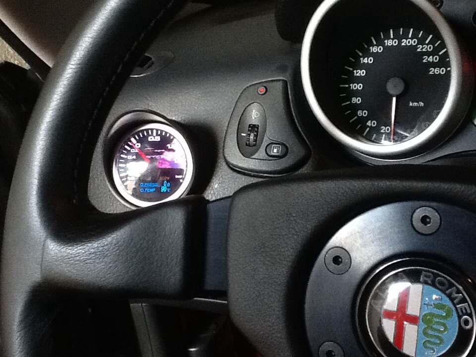

and this is a depo multi gauge.
Actually I do not like the looks of it but it does the job.
If I was rich as Damgreg said I would have bought the Greddy gauge.
The depo gauge is not the best looking one but it is cheap, it has all the sensors you need in the package and it is easy to install.

Hmm, is this GTV butt some post above of your car? I ask you, because of the number plate country.
So this gauge show boost, voltage, oil temperature, oil pressure and external temperature? Good solution for saving dash space.

Why your car is with greek registration? You have moved to Greece?
I havent. But I am going to use my GTV  only as a summer car from now on... and since I am spending my summer time in Greece... :)
The gauge is no the best or the most nice one looking. The reason I choose this gauge is exactly because of dash spare.
