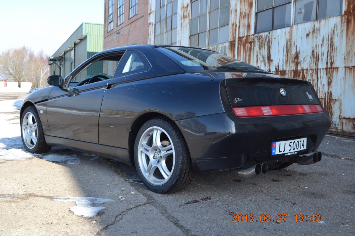

Time to update this thread:
Drove the car 750km the last five days with 500 of them the last 24 hours. Average consumption of 7,8l/100km... I think that is a great result...
I have some issues with some "jumping" from time to time when I give full pedal... I think I have to check all hoses...
During the rest of the easter I will install alpine speakers and a radio. I also need to polish and give it a proper clean during the weekend.
So a short summary:
*New front wishbones both sides
*FK Coilover kit installed
*305mm brembo brakes installed
*Goodridge braided brake hoses installed
*New thermostat installed
*New front wheel bearings installed
*Squadra chip installed
*Large engine service
*Dent on right side is fixed and right side has got new paint
*K&N replacement filter installed
I have also finally received my brand new MiTo!!!
:happy0045:
Happy easter to you all :D
