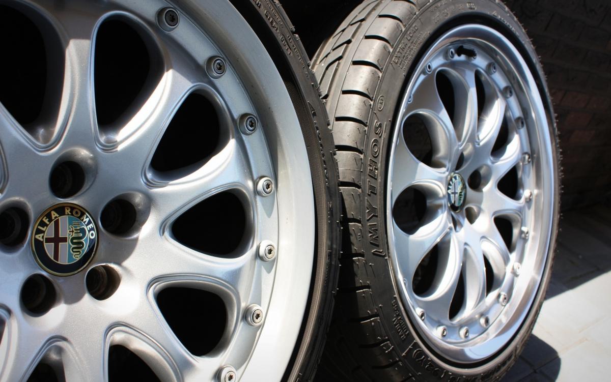

Started to trim the Siena's! :happy0045:
First sanding the lips with 400 - 800 - 1000 and then with the Dremel and Belgom Allu to polish it up.
And finishd with Rimwax for shine and protection.

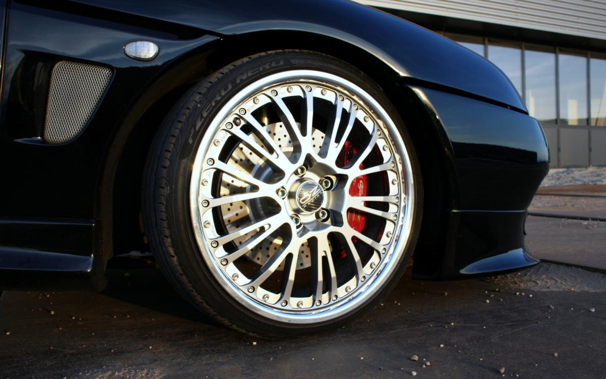

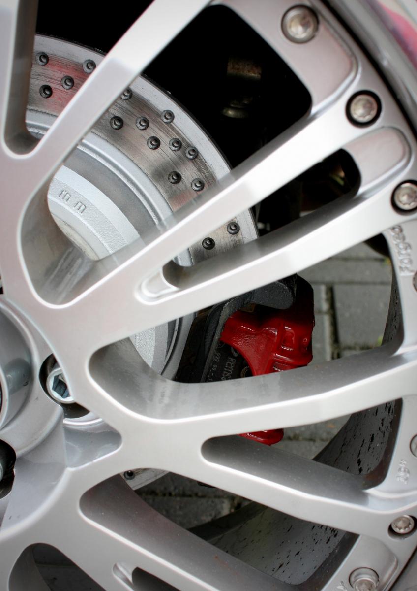

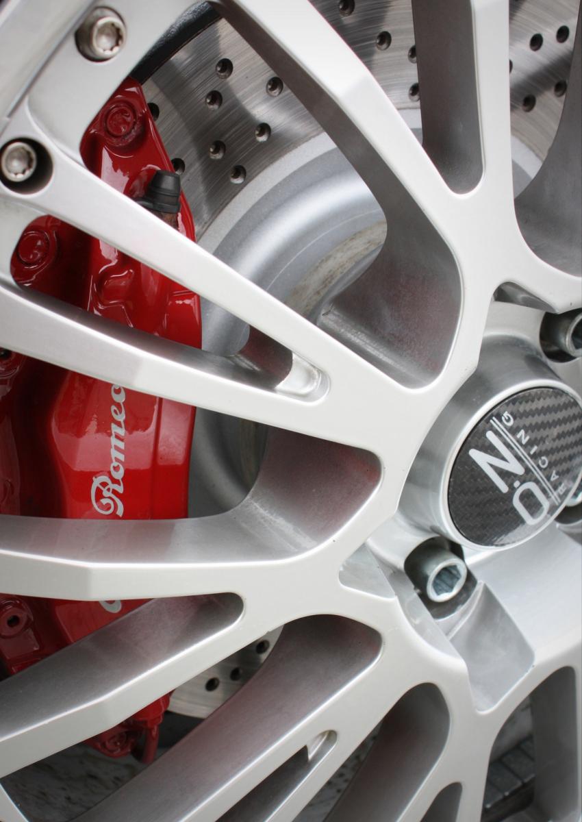

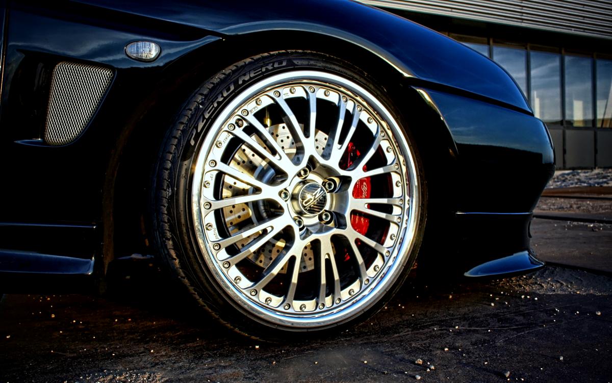

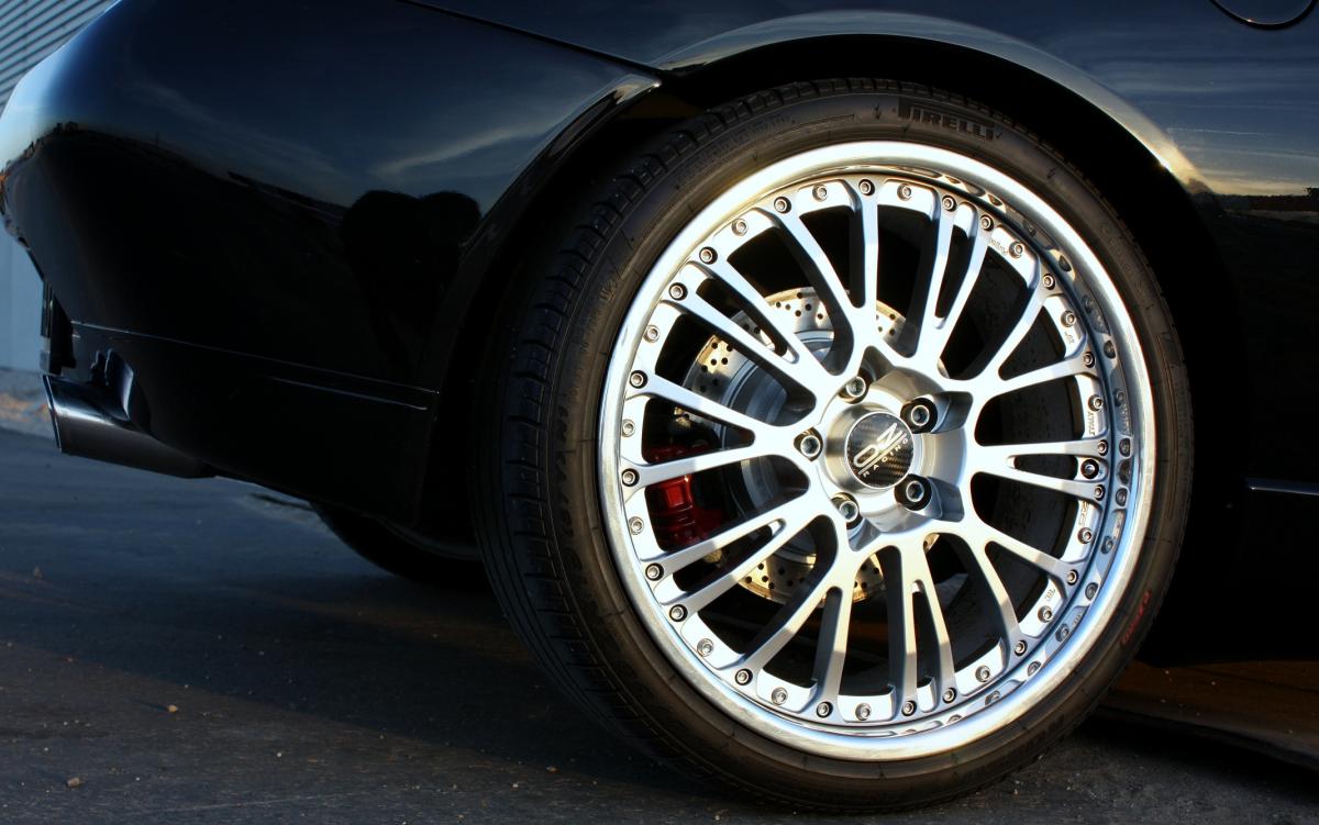

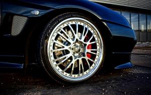

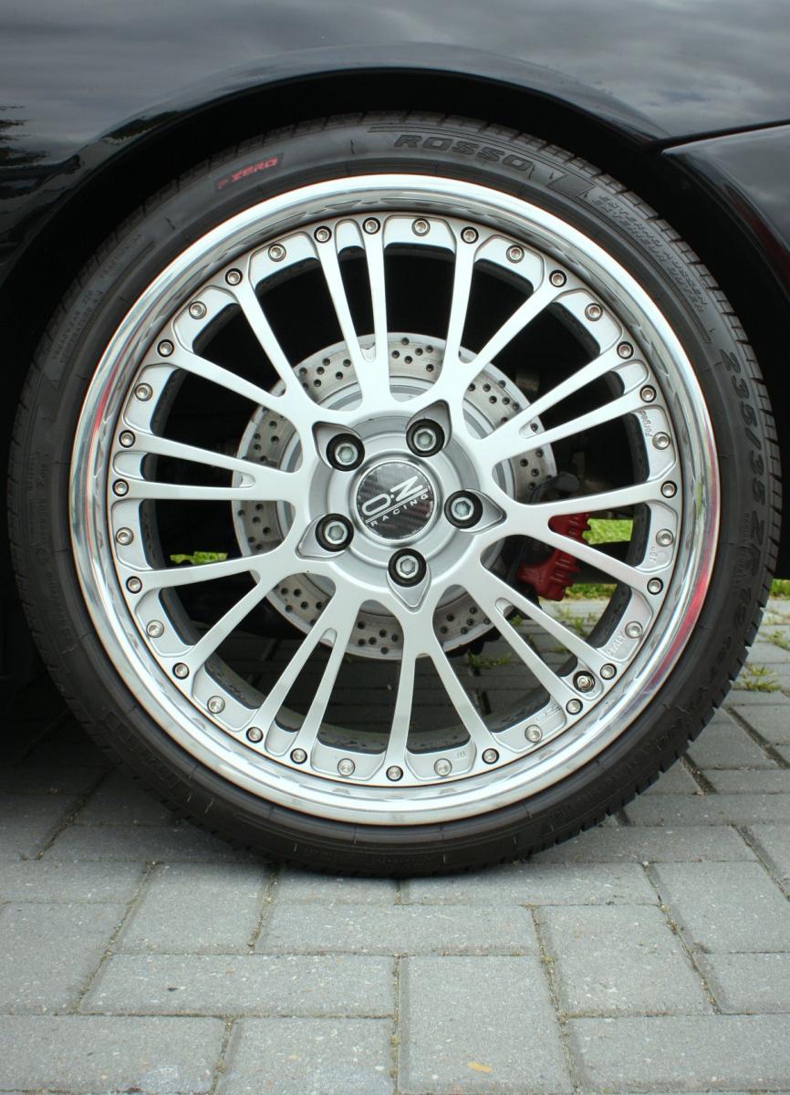

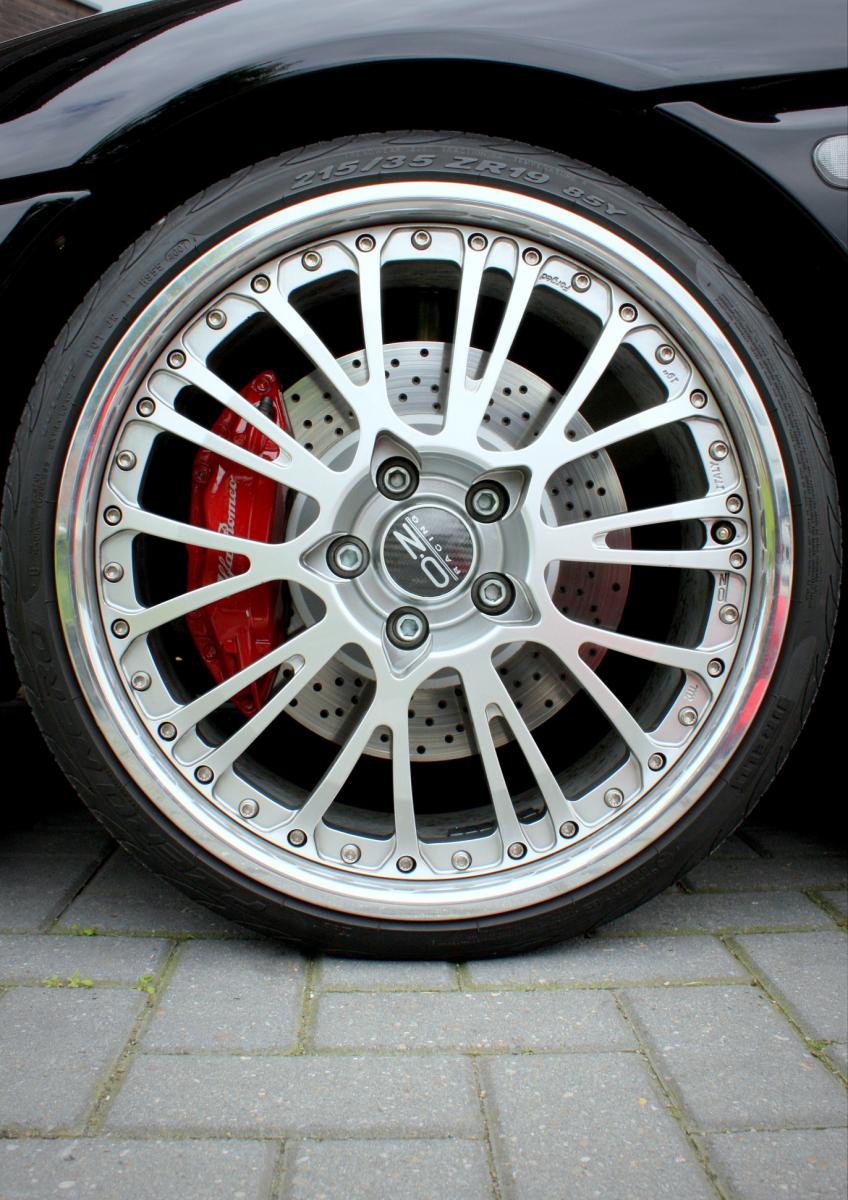

New Brembo brakes at the back with custom brackets thanks to Fabian!
With original calipers now got 295mm instead of the original 240 :happy0045:
Its plug and play with the custom adapters, didn't need to change the cables.
Also got the front 330mm Brembo's with the same drill :wub:
The rear breakes are from the Fiat Ulysse right?
A nice old solution to get much better looks on the rear axle :thumbsup:
Good brake upgrade for these big 19" wheels  :thumbsup: . What disk and pads did you use? And I think that my 215/45/17 tyre are low and now I see that you use 215/35/19  :o at the front. Probably you have very smooth roads in Holland or for you styling is very very important. I remember that have read something on the subject (style and beauty vs comfort and practicality of wheels) from one AUDI owner in their forum here:
" ... there is something very important of owning one car, when you walk to her you have to like it!"  ;)
P.S. If I have such space for brakes (19" wheels instead of my 17") I think that will go for something much bigger than my current setup (calipers and discs)  :D  :smile23: .
Styling is very very important I drive the 916 Spider now for almost 6 years and every time i see her i still get excited :wub:
:laugh2:  I first need bigger wallet before i can buy bigger brakes, maybe something for next year... :rolleyes:  :smile23:
 Don't know if its an old solution, i never seen it before on 916?
They are Fiat/Alfaromeo Brembo discs from what car they are i can't see.
:thumbsup:
I know a couple of 916 that they have done this modification before.. and many 147/156.
It is a great update if you have 330 discs on front.
The old 240 discs look ridiculus small especially in combination with bigger wheels like yours.
  On 6/4/2013 at 13:39, Thanos said:
:thumbsup:
The old 251 discs look ridiculus small especially in combination with bigger wheels like yours.
yes the old discs are tiny...
Joris you don't say anything for pads that you are using. It will be good to write your opinion for comparison with old brake setup  :)
Thanos can you give more information about rear brake upgrade from Fiat Ulysse (if you want in another topic) I don't remember to have come across such upgrade. There is rear upgrade kit by Tarox.
These are indeed discs suitable for the Fiat Ulysse (amongst others).
Great thing is that the bore is correct (5x98), only negative thing is that the dish is a lot deeper.
The bracket is a really simple one, the swept area of the disc is perfect for the small 916 pads as they cover the disc completely.
We didn't change the pads, as this was a low budget upgrade.

I'm courius on those brackets for the rear brake calipers...
Do you fabricate those Fabian? Is it possible to buy a set from you? :)
