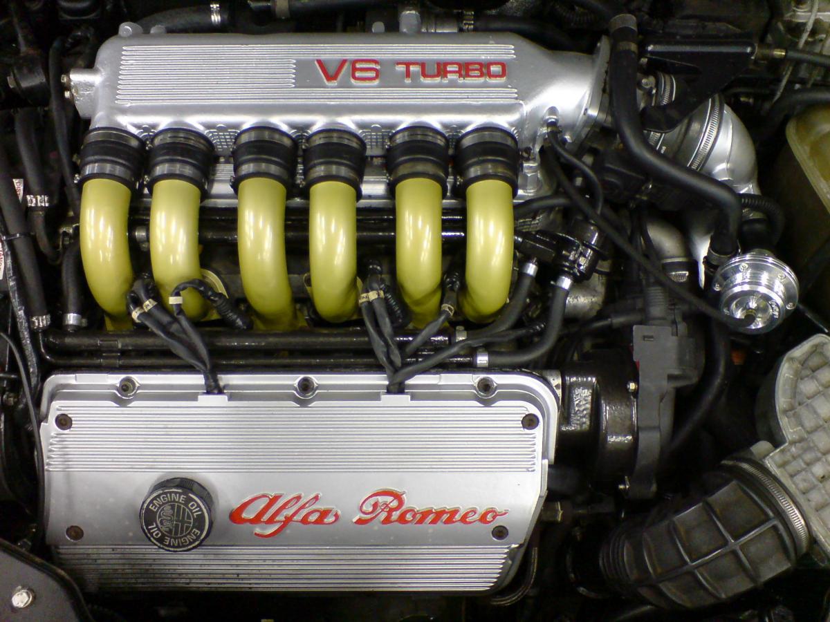

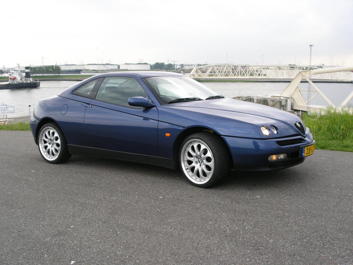

I have a GTV V6 Turbo from '95, Blue Atollo.
It has a Squadra Chip set which gives a lot more fun! (But not enough off course, never...).

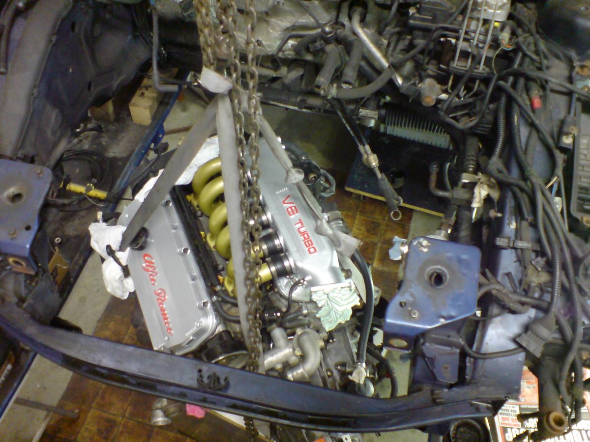

- Rebuild gearbox (@ my own workbench)

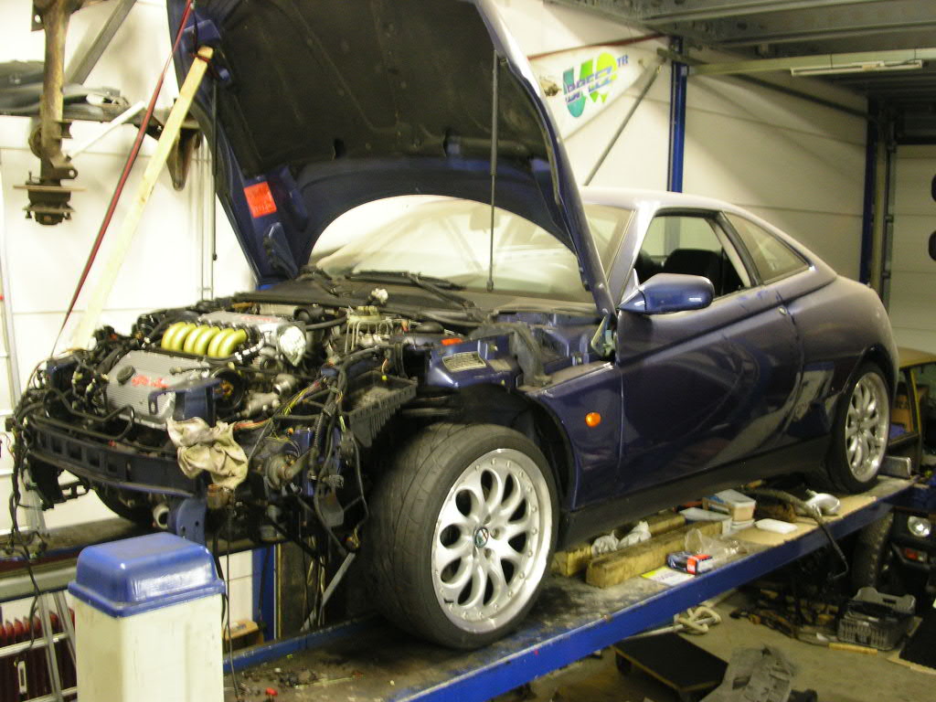

Hi Carlo, looks like your workshop is in a tent? If so I can imagine the in the fridge statement...I wouldn't like to work on my car at temps below 10 degree C.
Super slow reply @ PHRI: It's definately not a tent, haha. Its a 2x 65m2 business unit with big overhead door and central heating with two car lifts installed. So tempertures below 10degrees C (or -10) are no problem. :thumbsup:

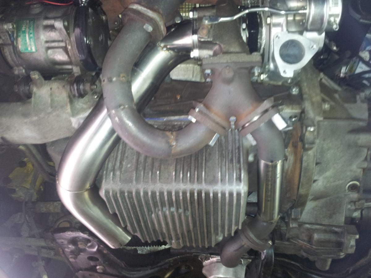

Some progress made:
- Turbo Y-piece and a little piece of the engine block altered to make room for the bigger turbo
- Connection pipes from front and rear header altered to new position / orientation from Y-piece. Even achieved a bit more clearance to avoid unwanted contact to the tarmac...
- The 70mm downpipe is finshed to the drive shaft area. The rest including theflex pipe is spotwelded in position. Now I need to order the 5" (!) race kat. to complete the downpipe / kat. Even the 70mm downpipe has a bit less chance to hit the tarmac...
- Made an adapter to connect the 70mm downpipe to the Original 60mm exhaust system (later on I will make this in 70mm too splitting at the rear axle in 2x 55mm)
So exhaust department is quite sorted out.. But still lots to finish off course.. :D
